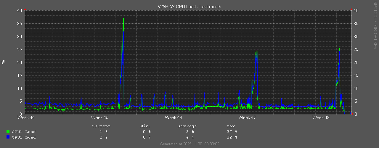

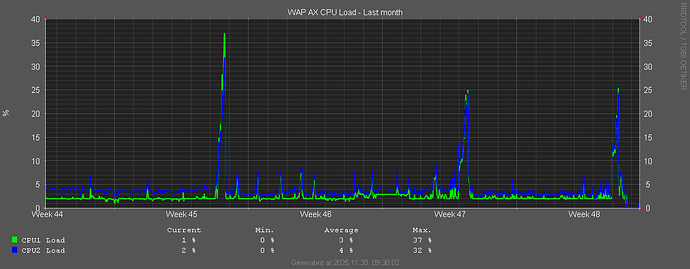

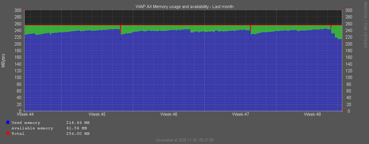

Every 5 to 10 days the WAP AX runs out of memory, the CPU load gets higher and higher (maybe zram?), then it becomes unresponsive, and either it reboots itself or we reboot it due to service outage.
It runs latest 7.20.5, we have tried most 7.20 versions since we have it, but all had the same issue.
The WAP AX has about 45 MB RAM free out of 256 MB when doing nothing. This gets less and less over time, then it crashes.

The Wifi interfaces are disabled since Yesterday, a few scripts running, to see if it is the scripts that causing the issue. It has 41 MB RAM free. We are monitoring the situation.

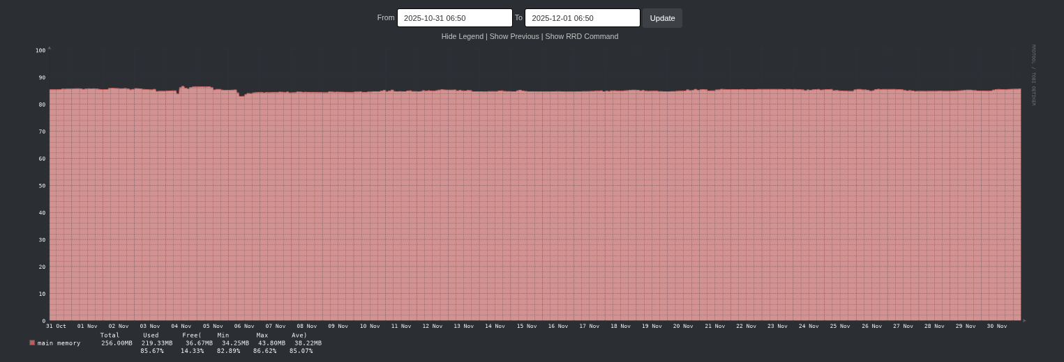

My wAPs ax only have 3 bridge rules and nothing else besides being controlled by CAPsMAN. However, they always run at 87%-91% of RAM usage, which is quite high to be honest.
I hope the next generation has more RAM, but also that at some point a memory profiling tool is introduced.
My wAP ax has 256MB RAM and is consuming around 220MB. It's not changing over time so I'm not worried.
If device is not crashing with some sort of OOM condition, then seeing 95% of RAM used means that ROS is utilizing resources as intended.

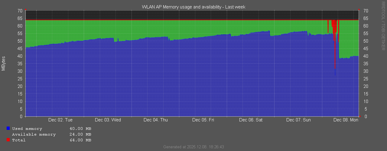

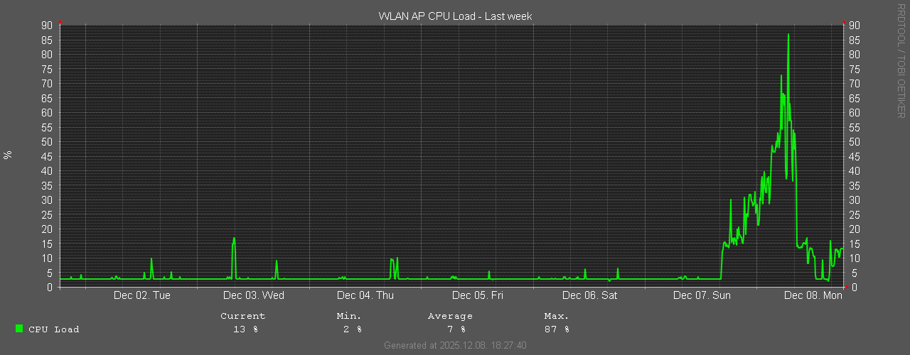

WAP AC with 7.20.5 also crashed with out of memory. It survived about 9 days.
See the graphs, the same pattern as with the WAP AX, CPU load starts to grow, device starts to not respond to SNMP (resulting in the choppy memory graph), then reboot, memory usage falls back.
The last known good version is 7.19.4 on the WAP AC, that was the version running fine before the WAP AX arrived. Then WAP AC was upgraded to 7.20.4 then to 7.20.5. So I think there must be some sort of regression affecting us, and may be related to the scripts.
We will go back to 7.19.4 on the WAP AC and test again, and if it works, test WAP AX also with 7.19.4.

I can see that the "CPU consumption" was going on for a whole day .... so when/if you see it again next time, check what in particular is using up the CPU cycles (run CPU profiler). And if you do see something weird, create a supout.rif and attach it to issue ticket you're going to open with MT support.
