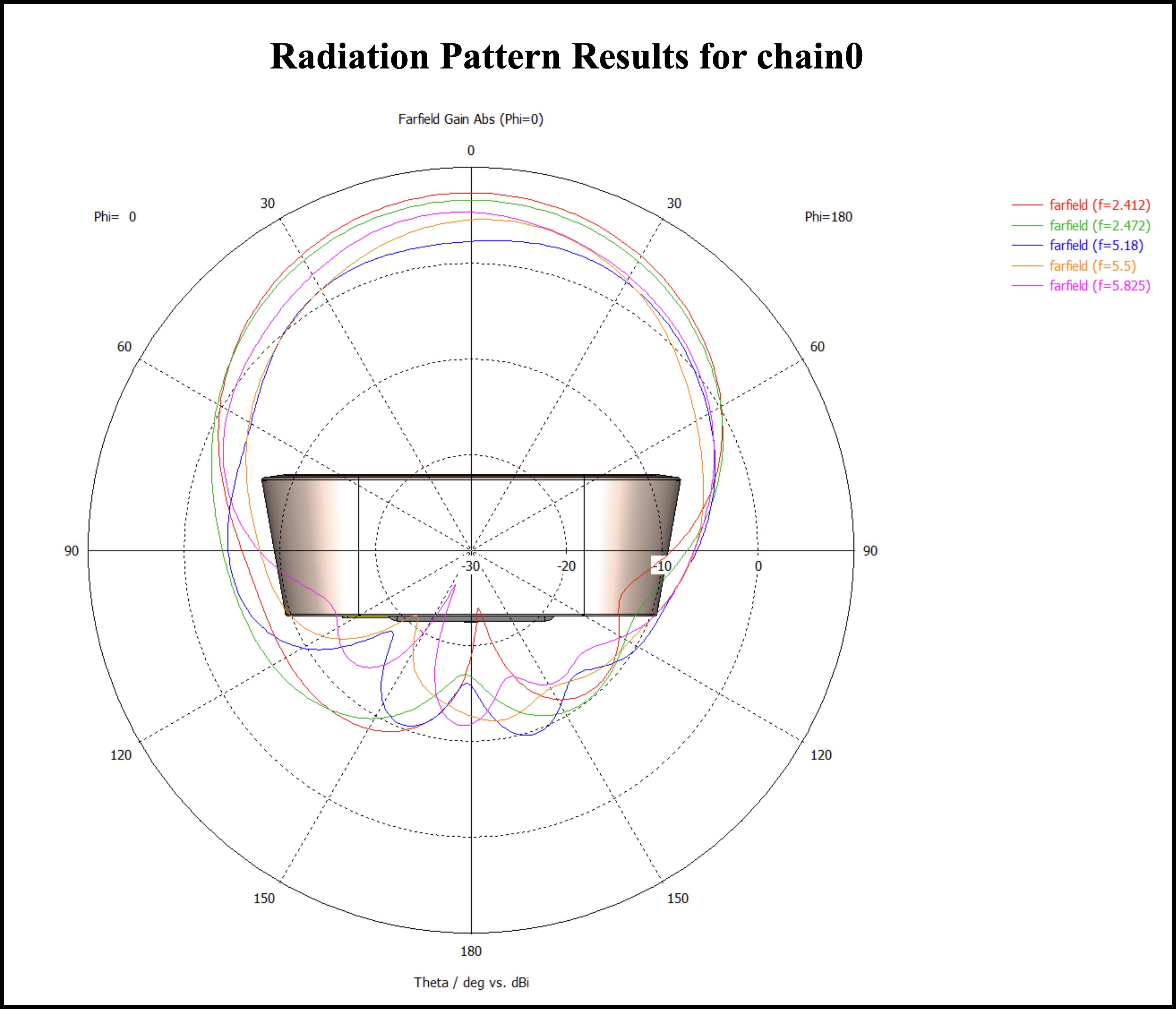

FCC website has radiation patterns and test results here:
https://fccid.io/TV7WAPGR52AX/Test-Report/Antenna-specification-7634095
Here’s a screenshot from one of the pages:
So wAP AX seems to be directional.
Correct antenna gains seem to be around ~7dBi in the frontal direction.
Thanks for the image.
Around 7 dBi for 2.4GHz band and around 5 dBi for 5GHz band.
There’s definition about “directionality”: antenna beam width is angle where antenna gain drops by 3dB below maximum gain. So from the diagram one could deduct that for 2.4GHz band beam width is around 90° (center ± 45°) and for 5GHz band it’s around 80° (center ± 40° … and center is shifted from right towards left as frequency increases … yuck).
