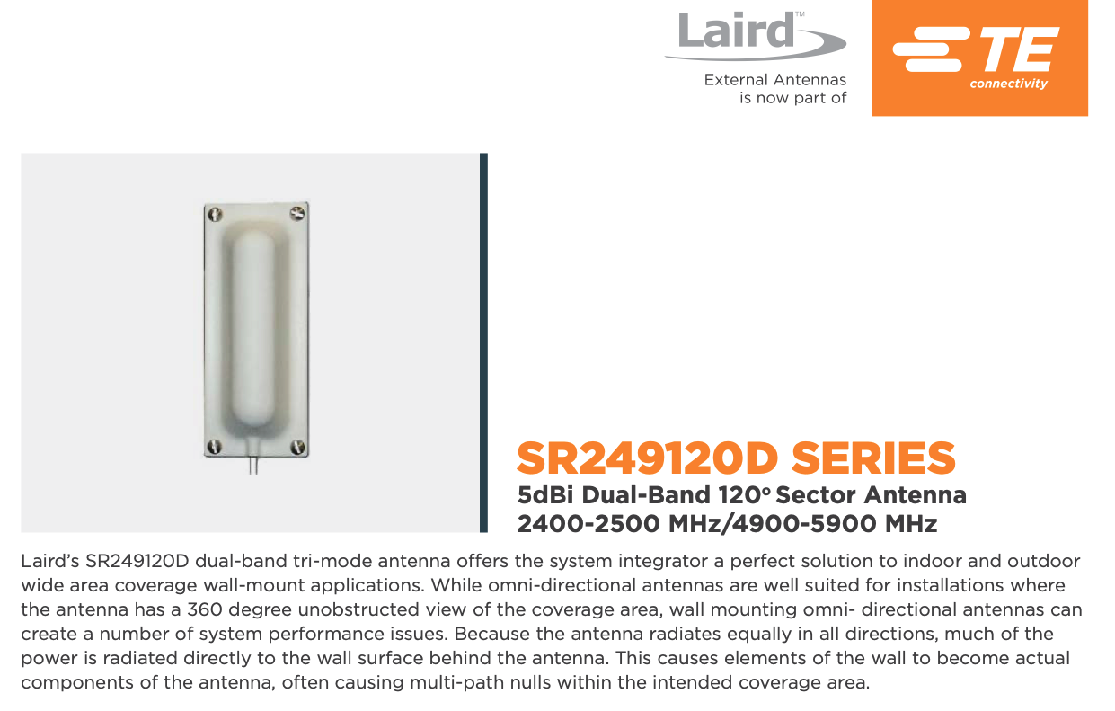

They exist, but I think there isn’t enough demand for them to keep making them (people want more gain, not to be hampered by dual-band designs).
This is one I found at one of my distributors. Based on the “802.11n” description, they’ve been around for decades but haven’t been updated and aren’t in stock anywhere.
