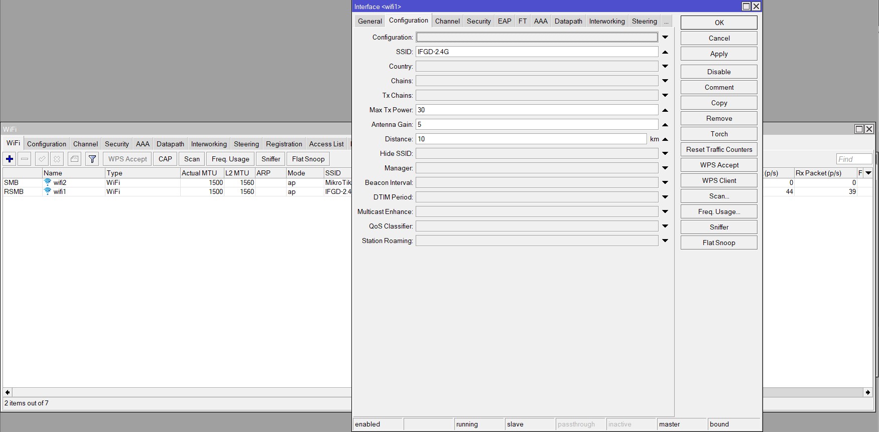

i have a mantbox, am currently using it as a test indoors, but the signal strenght is’nt good at all what could be the issue.
My main focus is to provide out door coverage with the mantbox
mANTbox has a pretty narrow-beam antenna. Have a look at diagrams, published in product’s quick guide. Since Tx power is generally limited by country regulations, this means that decent signal strength is only available in directions with maximum antenna gain and elsewhere signal strength is pretty low.
