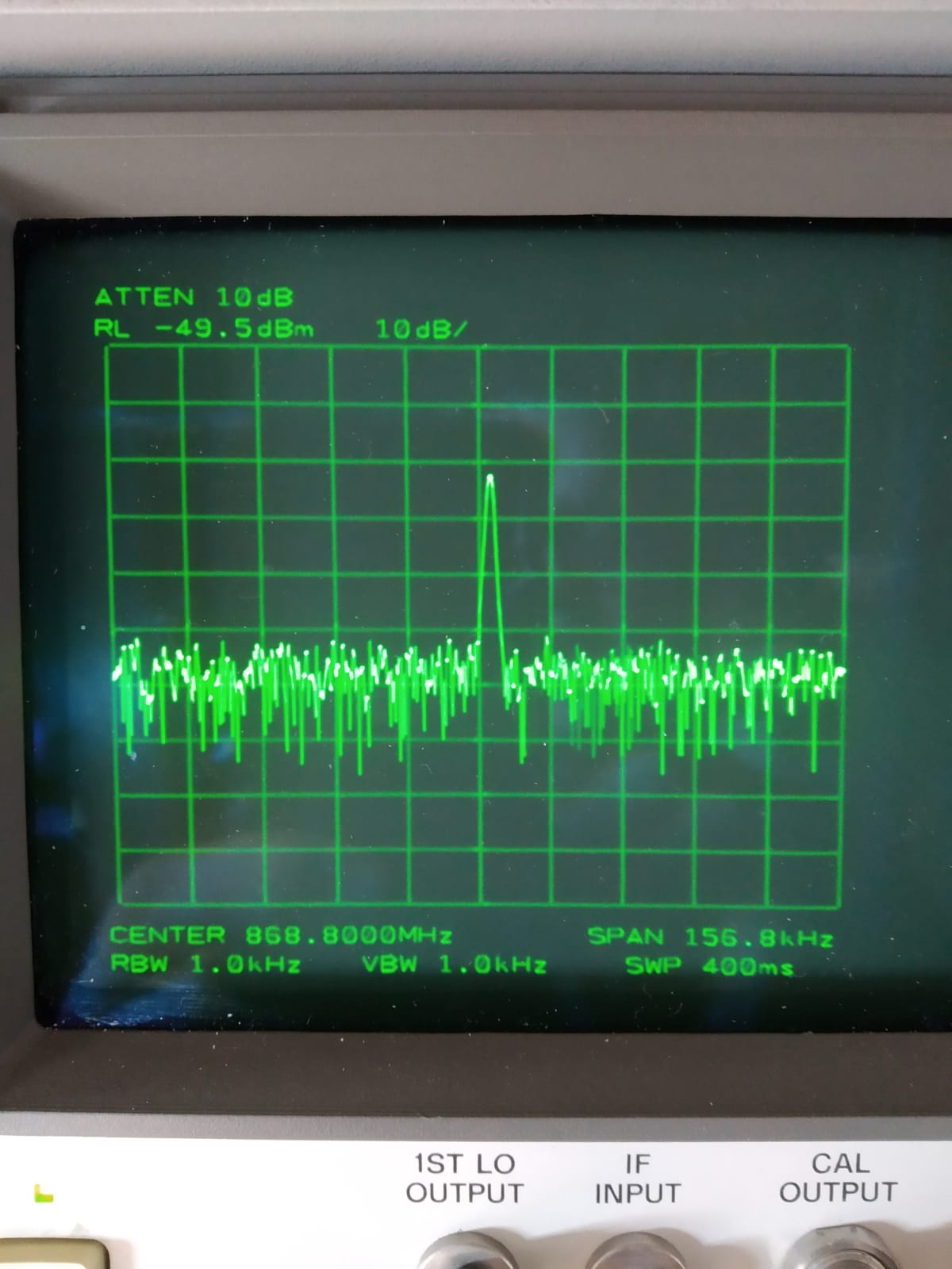

which seems correct and then the wap receives it and transmits it but the end node is not receiving anything. I have checked with the spectrum analyzer and it seems that wapR is just sending a tone at the 868.8 Mhz but not the FSK signal (see attachment 2)

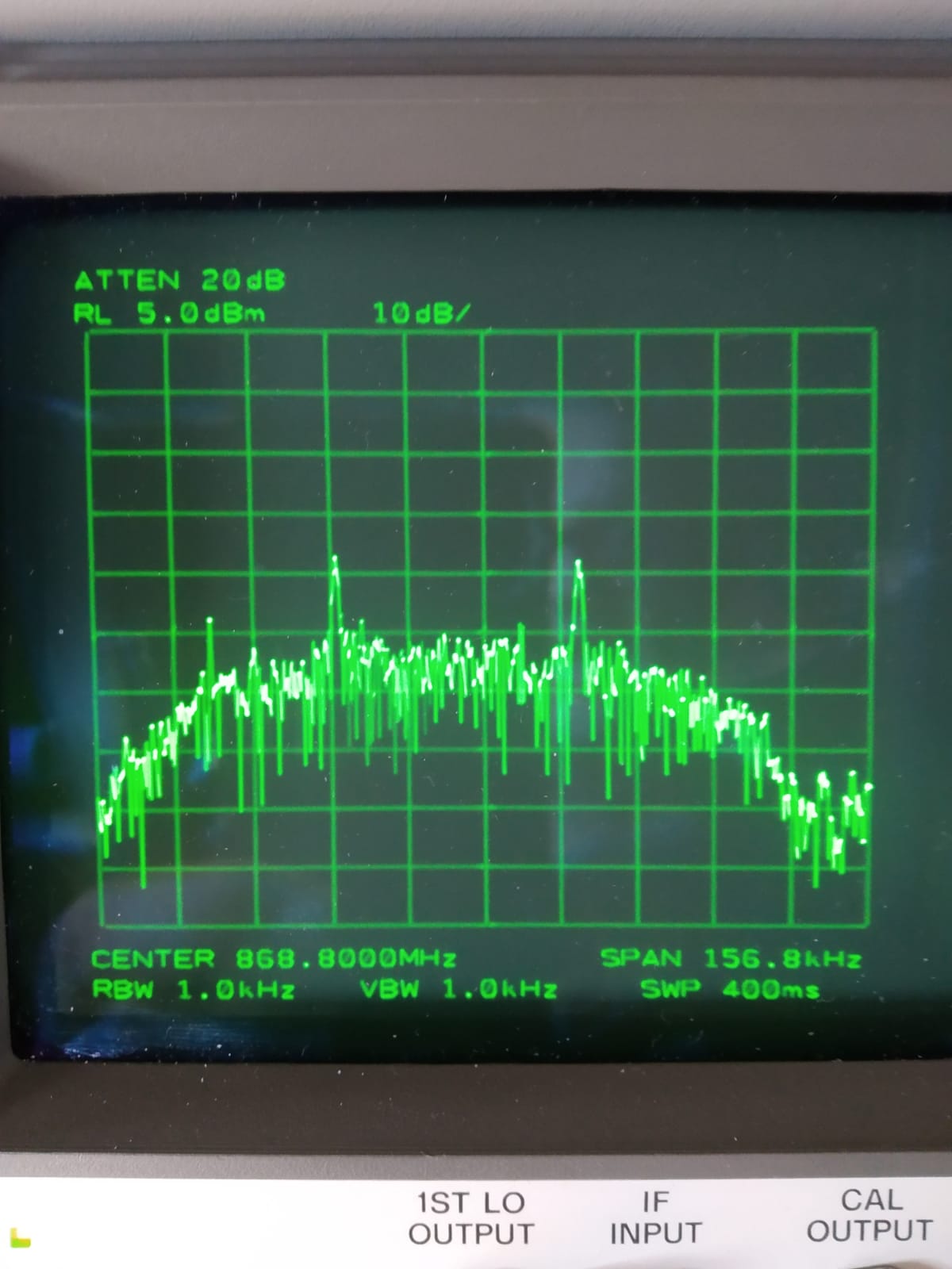

If I send FSK uplink from a node device, the wapR receives it correctly and forwards to chirpstack (see the correct FSK uplink in attachment 1)
