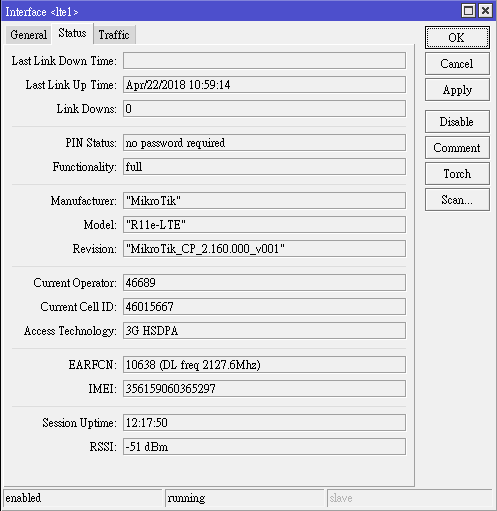

The carrier network always stayed at 3G HSDPA, and the speed is very slow (DL: 4-5Mbps, UL: 500-600Kbps)
I tried to remove internal antenna and add external antenna from the board.
The RSSI value rises from -61dBM to -51dBM, but the access technology was still locked at 3G.

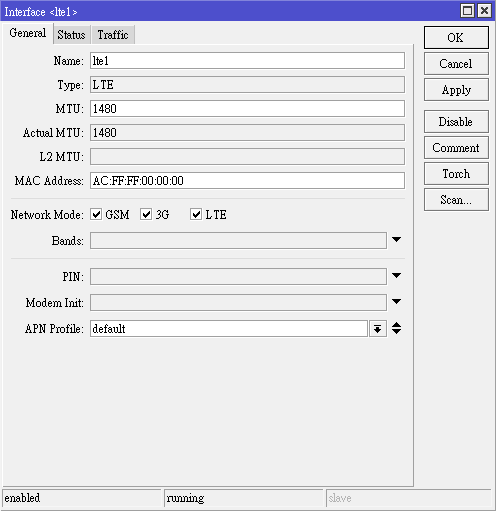

I also tried to enable LTE only (disable GSM/3G) of Network Mode in lte interface, but the link always down.

Firmware Version: 6.42 (Stable)
R11e-LTE Revision : MikroTik_CP_2.160.000_v001
