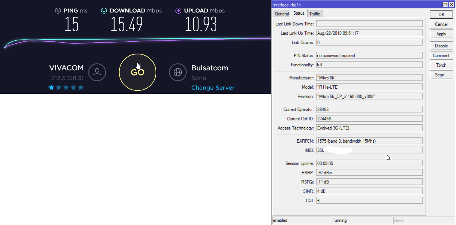

Same here, I can’t believe how it is possible…
wAP LTE kit (ROS 6.42.7) - ping 15ms , Download - 15.5Mbps, Upload - 10.93Mbps.
Huawei E3372 - ping 12ms, Download - 27.5Mbps, Upload - 27Mbps
Both devices are placed on exactly the same place on my desk.
I’ve the feeling that antennas on wAP or sensitivity are not quite OK, what could be the reason ?
Do someone try to replace RB11E with another LTE card ?
Yeah could someone propose tested CAT6 modem fot that device?
Another test, from different location (with better LTE covarage - SINR 24db/CQI-15).
wAP LTE kit (ROS 6.42.7) - ping 13ms , Download - 70.95Mbps, Upload - 24.73Mbps. (LAN connection)
wAP LTE kit (ROS 6.42.7) - ping 14ms , Download - 61.7Mbps, Upload - 24.07Mbps. (WiFi connection)
Huawei E3372 - ping 14ms, Download - 84.1Mbps, Upload - 31.64Mbps
I’m wondering what can be the reasong why R11E (LTE CAT4) can’t reeach speed of E3372 (LTE CAT4)?
Do someone manage to reach more than 75Mbps/30Mbps with wAP LTE Kit ?
