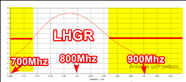

B20 is 800Mhz - this is only one “half good” band at this SXTR/LHGR/LDFR because

I would not recommend B20 (800 MHz) on either LHG or SXT because of the bad antenna gain at that frequency. Use a dedicated antenna for B20 or even better, take SIB’s advice using the upper LTE bands which are generally better suited for datacom.
