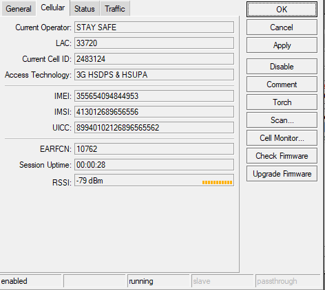

The LTE interface not working if I enabled 3G Only. in the previous OS version 6.49.6 that work 3G only. anyone have idea??? because there are some locations that not have LTE Signal.
I believe there are locations that do not have 3G coverage too…
Signal level is low. but i think it is enough to connect. LTE interface also running. but it will not connect internet. without any other changes it will work if I change only network mode to the LTE.

Changing network mode to something else then 3G only does make it work ?
Did you already verify if a new firmware is available ? In your screenshot “Check Firmware”.
If a newer version is available, select Upgrade.
Unfortunately, as it is now, that part can only be updated over the LTE connection (as far as I know).
CAREFUL: preferably ONLY to be done when you’re connected to the device directly.
I had one occasion with a device 930km away and the update went wrong … some weeks before I was able to get on site and do a complete reset to restore functionality.
