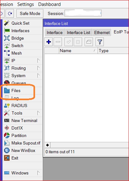

tried out. Where can I find the exported file?
Hi there there should be no spaces between file equal sign or test, thus: file=test
It will be found under FILES :wink:

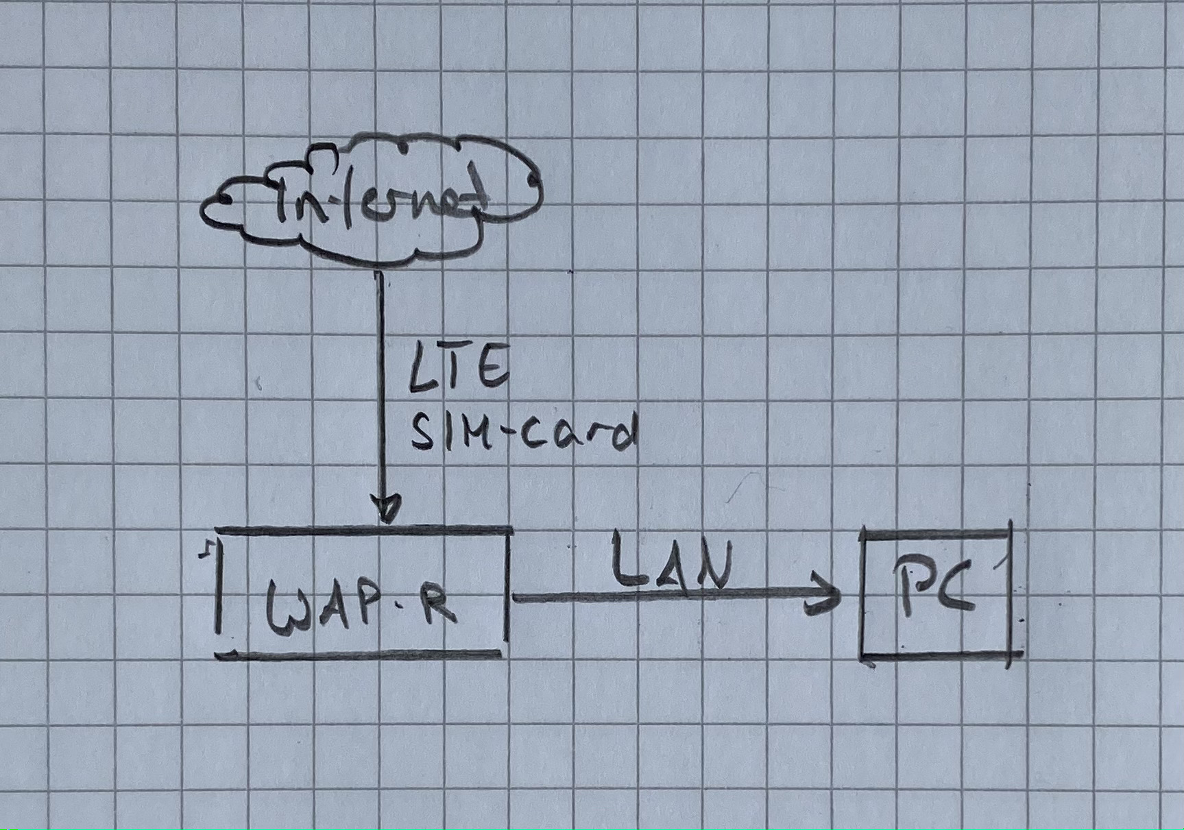

Can you draw a network diagram to show where internet is coming from and what your network looks like behind the mikrotik device?
Also state clearly what your expectations are for users or devices on your network.
[ so far I am guessing, is that you have an LTE capable router, that gets internet from a provider with a fixed private IP of 192.168.88.X, with gateway of 192.168.88.1]
But then you have no subnets for your own use no LAN?)
[1] Thank you, I deleted one address.
[2] I would like to access the Internet with the WAP-R using a SIM card. The router should then supply every connected device with the Internet via a LAN cable.
[3] How can I create a network diagram with Winbox? Unfortunately, I am not very familiar with Winbox.
Easiest is papier and pencil and a picture :laughing:
Hi there,
the functionality should look like this:

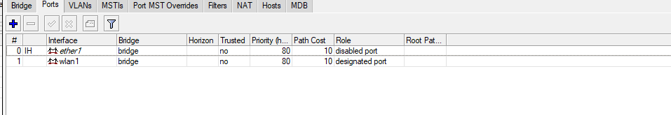

To be honest, I’m still a little overwhelmed with the steps ..

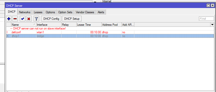

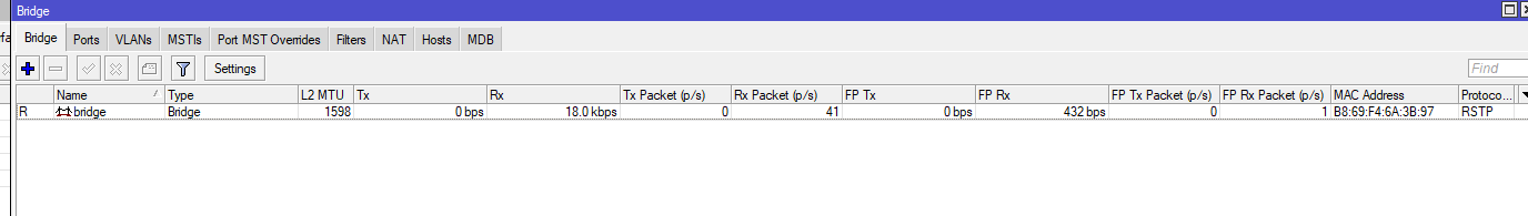

At first I tried to implement the points mentioned below. Pictures in the attachment
Unfortunately, I don’t know exactly how to implement these points: :confused:
Your DHCP server is currently only serving wlan1 and I don’t see a bridge where eth1 can be part of. If you add a bridge and put eth1 and wlan1 as part of that, c**hange dhpc-server to bridge** (which you will have to do anyhow since wlan1 will become a slave if you add it to the bridge)
I don’t see a default route towards lte (and that definitely should be there): add route to 0.0.0.0/0, interface lte, distance 10[/flash][/flash] (I prefer to have the default path a bit out of the way, experts may disagree with that one)
Post your lastest config !!
As Anav said (without the exclamation marks :slight_smile: )
On your lasts screenshots, the one for DHCP server: remove the line in red with defconf. It is invalid now because wlan1 is part of the bridge.
You can not run a DHCP server on a slave interface.
And then provide your export again please.

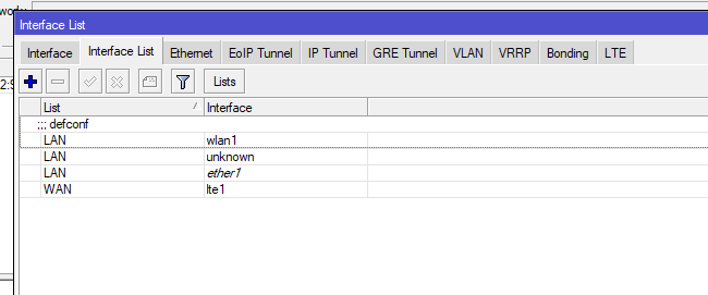

(1) Lets tidy this up…/interface list member
add comment=defconf interface=wlan1 list=LAN
add list=LAN
add interface=ether1 list=LAN
add interface=lte1 list=WAN..
TO

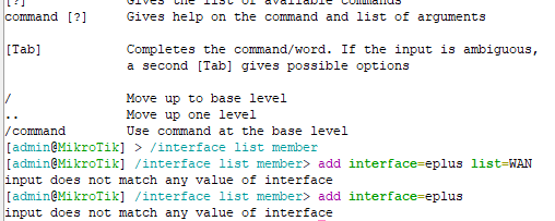

add interface=eplus list=WAN {just to be sure we are capturing all possibilities as not familiar with LTE}

[1] Unfortunately I had problems with this point .. Picture in the attachment
The rest has worked so far. This time I even changed the name of the file: D
