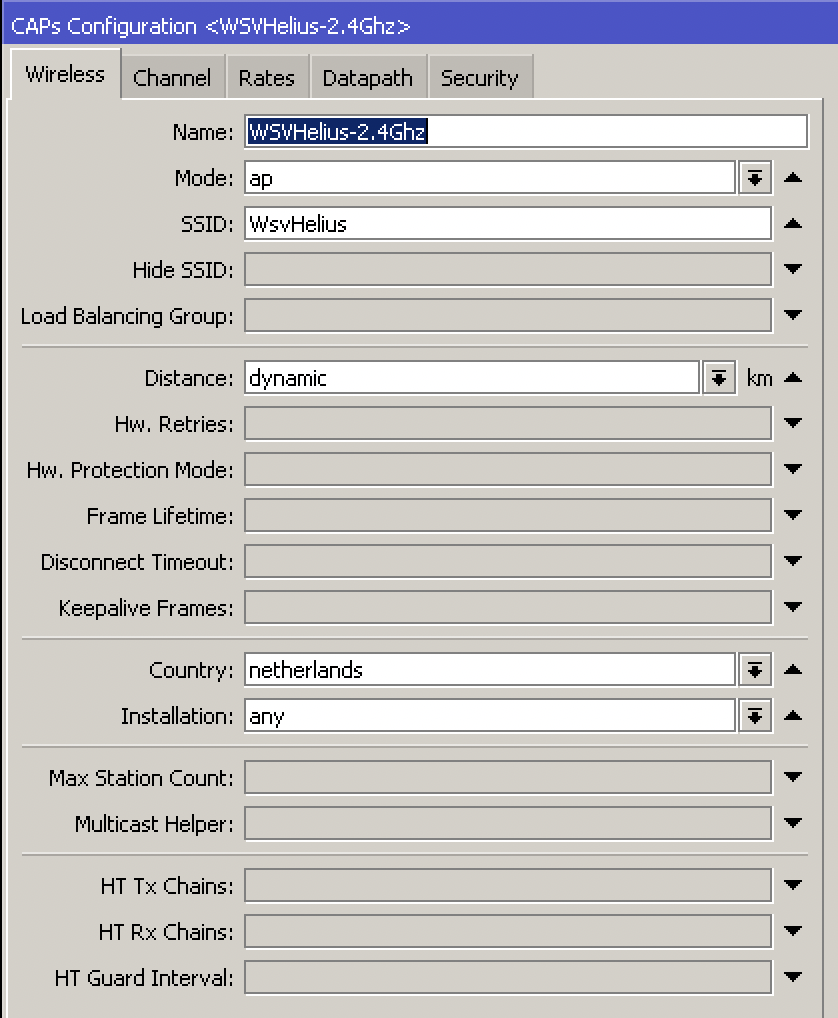

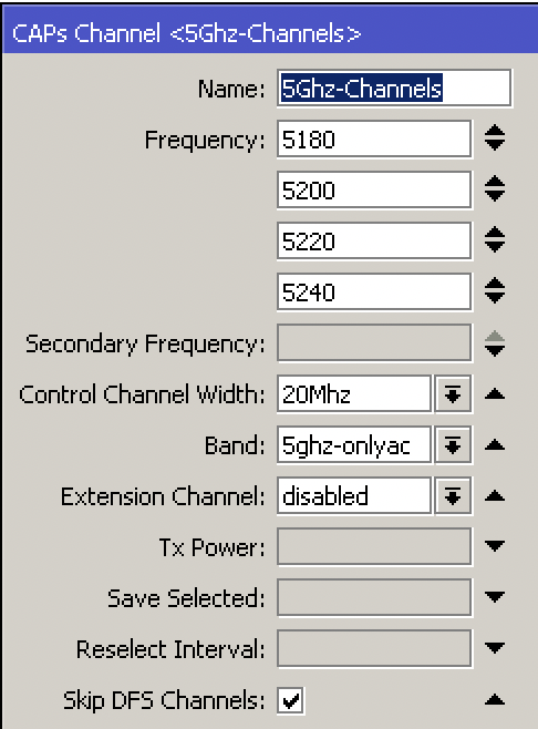

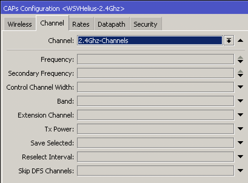

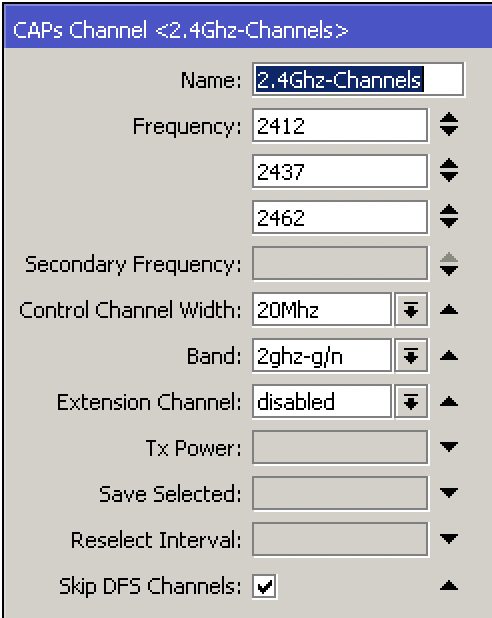

I’m having a number of RBwAPG-5HacT2HnD (wAP) devices and when testing the WIFI signal I notice that when I get further away at about 10 meters the performance drops to really low values.
  • Beside the wAP AP I measure about 96 Mbit/s on the iPhone.
  • When about 10 meters away, I measure about 4 to 5 Mbit/s
When having a a clear vision on the AP, is it normal that this bandwidth drops that much?
Some screen shots of the current config:

Looks like you are using CAPsMAN. To debug, do a complete system reset and try the same test with factory (non capsman) settings.
I finally concur with Normis, capsperson should not be used when learning about MT wifi at the beginning.
Once one understand how the wifi works and one wants to make the configuration more complex then necessary by all means go down the evil path…

  • The Netherlands housing concentration usually leads to crowded wifi cells. Check what else is using your channel. MT is not able to pick the best channel for you!

  • 2.4GHz should go further than 5 GHz but usually is overwhelmed by neighbors. For 5 GHz you use the “indoor only” frequency for Europe. You test 10 meter indoors, with a clear view on the AP? This really is a “groot huis” then.
  • Try the 5500 (channel 100) and up frequencies, which can be used indoor and outdoor. They have 4 dBm more power, and go 60% further. Yes these are DFS channels !!!

And the “play dead” time for the weather channels (5600-5640) is a full 10 minutes, after every change or startup. Selecting “10min CAC” for DFS Skip can avoid those.
