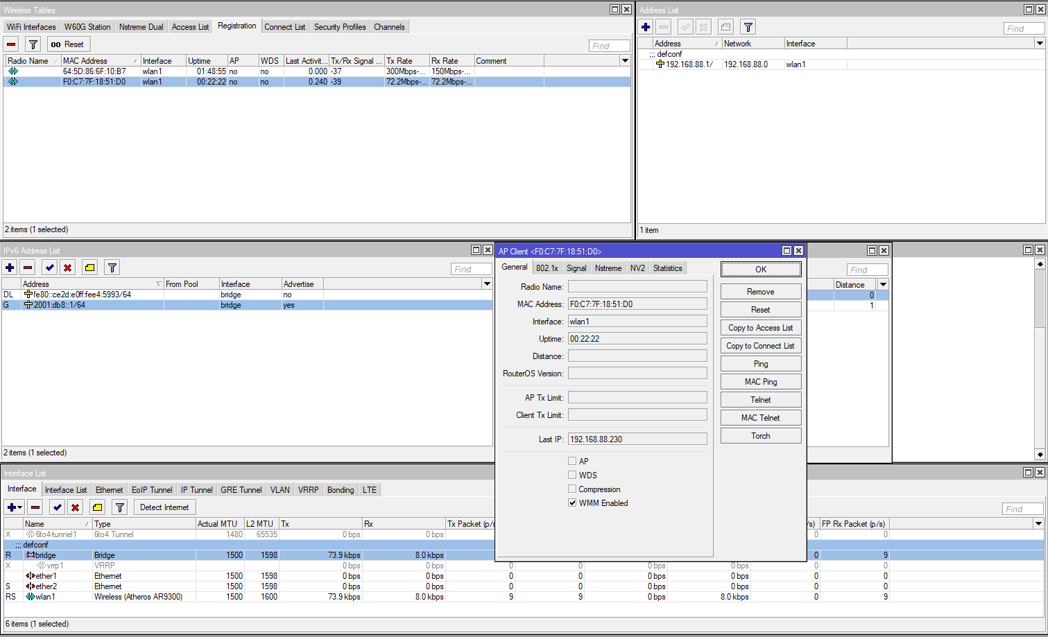

I tried to add a static global address, see the attached picture. Now I am able to connect my host using IPv6 but in the Wireless Tables/Registration I can always see IPv4 address instead. I can ping IPv4 as well as IPv6. This host is running a TCP server that can be connected with a TCP client unfortunately just via IPv4 and not IPv6. Any suggestions?
Try to ping closest host from server with ICMPv6.
I have already done this (ping the host using IPv6) and it works but I cannot connect to my TCP server running on this host using IPv6 (IPV4 works fine).
