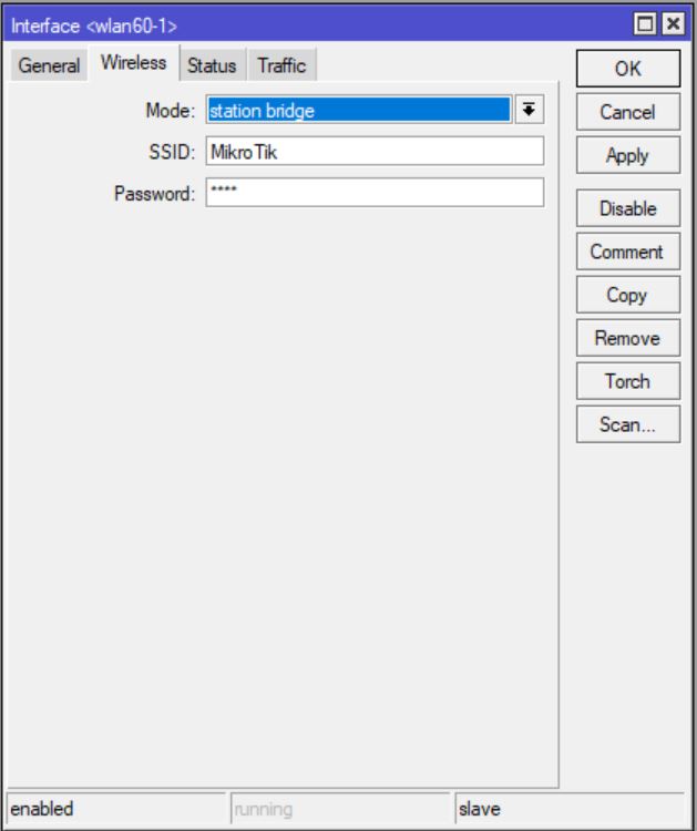

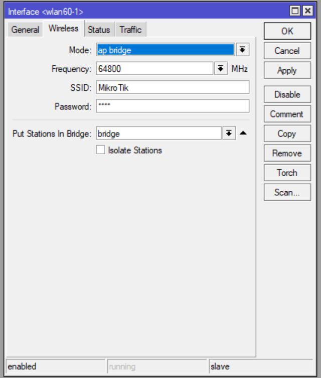

here 2 pics from my wap60g-ap (i changed to ROS 6.42.11),
one configured as station-bridge, one as ap-bridge.
When i do a scan…no wlan is reported…the interfaces seem to be disabled/inactive…
What do i wrong?

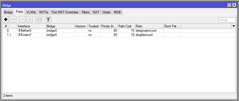

Same issue here. WLAN-port "w60g" (wlan60-1 OR wlan0) on AP (RBwAPG-60ad-A) is always disabled. In this case, the devices are connected to each other, but there is no traffic.

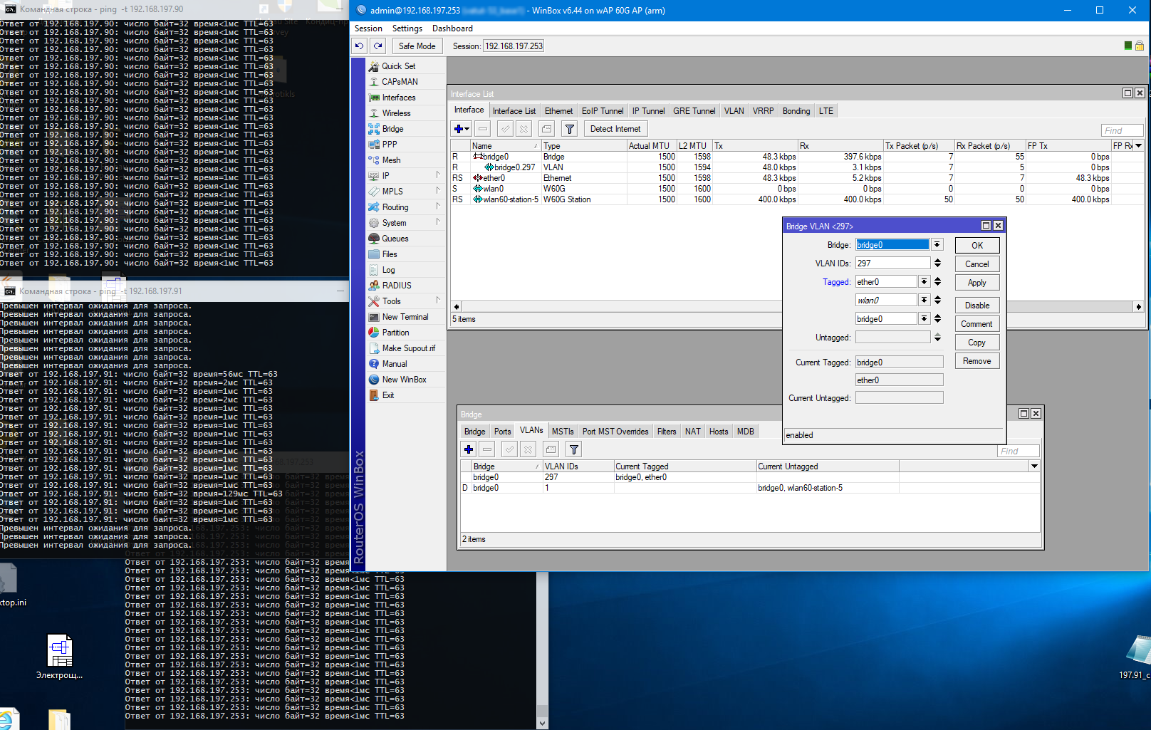

Because of this, VLAN-forwarding (Wireless VLAN Trunk) between the AP and Station does not work. Configured according to the instructions RouterOS - RouterOS - MikroTik Documentation -- no ping.
I hope someone can help me too.
192.168.197.90 - AP
192.168.197.91 - STATION

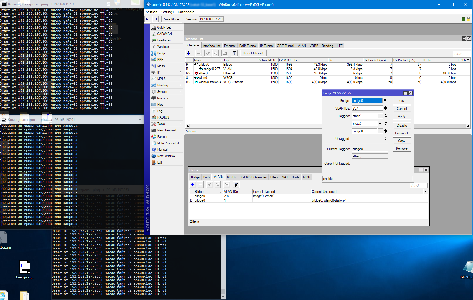

I will also add that the traffic does not pass into the MANAGEMENT VLAN (Vlan ID 297), if the settings are:
/interface bridge vlan
add bridge=bridge tagged=ether0,wlan0,bridge0 vlan-ids=297

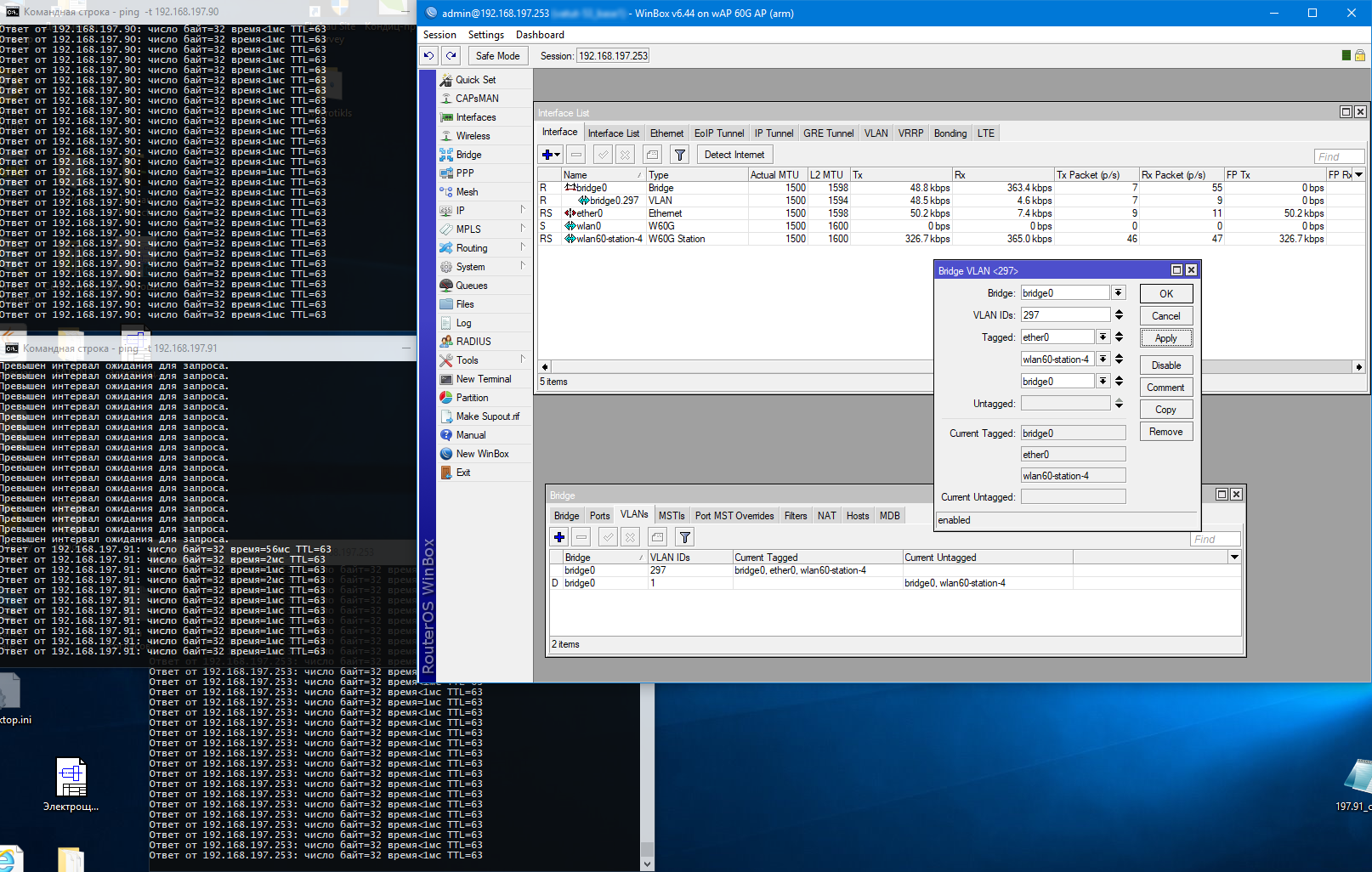

If configured like this, the traffic goes fine:
add bridge=bridge tagged=ether0,wlan60-station-4,bridge0 vlan-ids=297
However, if STATION reconnects, then the traffic stops flowing because the interface changes from wlan60-station-4 to non-working wlan0:
