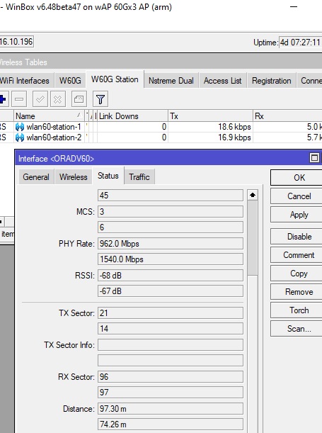

try 6.48beta48. Now it works for us. But we have only 2 clients…
Interesting, can you confirm you have a 60x3 AP? what are the link down counters showing since you installed beta48?
Yes, but only two clients on WAP60x3. 4 days uptime and no disconnect with beta48

74 and 97 meters. Situation:

Those signals look on the low side.
Yes, a lot of disconnections during the day. Maybe a few in an hour
In short distance is lots of disconnection. Is not too visible not. Speed. but is clearly. impacting. Voice and Video conference where is necessary of QOS.
