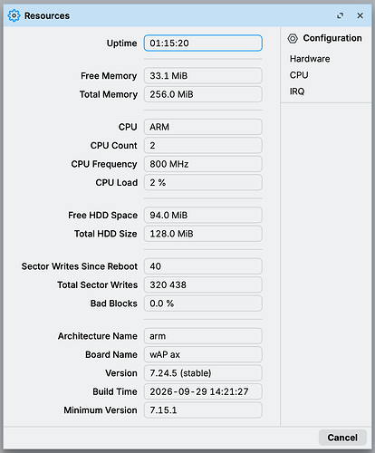

I have several Mikrotik devices, but my wAPax is the only one that's using 88–90% of its memory, even though nothing special is running or installed on it—it's basically set to default. Is that normal ?

My wAP AX configured as CAP is using 223MB of 256MB. Uptime of 10 hrs, 7.25rc1. Solid as rock, nothing to worry about in my opinion.
You talk about default...is it used as router (I think that is default) or accesspoint?
My haP-AX2 and CAP-AX's, used as AP only under CapsMan are using about 360MB out of 1024MB, fwiw . . . No firewalls, no filters, just 4 SSIDs. (Granted, ARM64)
haP-AC2 running 2 SSID's, a station mode radio, ipsec, firewall and router is running in around 80MB out of 128MB. It may be due to a typical tendency of Linux kernels to use free memory as buffer. (Not sure how ROS may or may not use this feature.)
If it's not blowing it out and crashing, myself, I would not worry.

Memory is there to be used.
My question comes from the fact that my wAPpax is the only one in my fleet that keeps showing a kernel failure from time to time.
