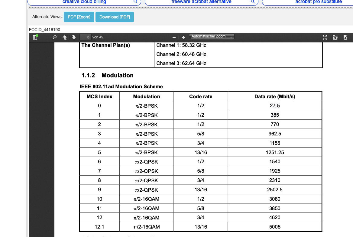

per this doc:
https://apps.fcc.gov/eas/GetApplicationAttachment.html?id=4416192
The requirement for stand-alone test configuration: The module cannot stand-alone during test. This module is intended for OEM integration only and limited to host with brand: Mikrotik and model: RBwAPG-60ad-SA, RBwAPG-60ad.
Ok so it is something like the mini-PCI modules used for LTE (and, mainly in the past, also for WiFi)?
And this:
i doubt. Mikrotik calls their modules as R11e-xxxx.
