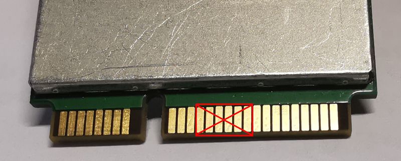

ok looks like the wAPR is only usb2.0 complaint and the Quectel comes as USB3 mode by default
so i need to stick the EP06A in an usb3 device… change the mode to USB2 and try again
i do not have a USB3 device
so maybe an external USB to PCIe adapter and use a PC to switch the mode?
as of today my wAP routerboard do not see the Quectel Radio
You can also put a piece of tape over the USB3.0 pins of the miniPCIe connector on the card to force it into USB2.0 mode.
Thanks!
i did that and now is working
