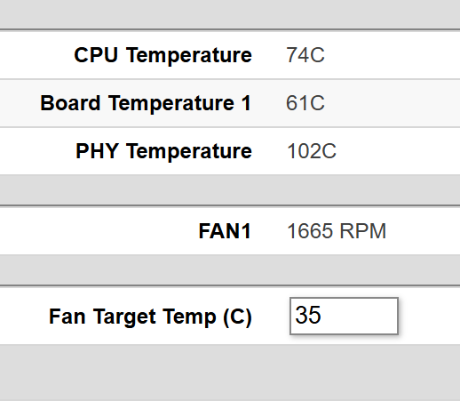

With the replacement fan the temperature of the entire switch is warm/hot to touch vs prevoius foxconn fan even if I set the Fan Target Temp (C) to 35C:
Which options if any do I have to lower the temperature of the switch with the fan Noctua NF-A4x20 PWM inside?

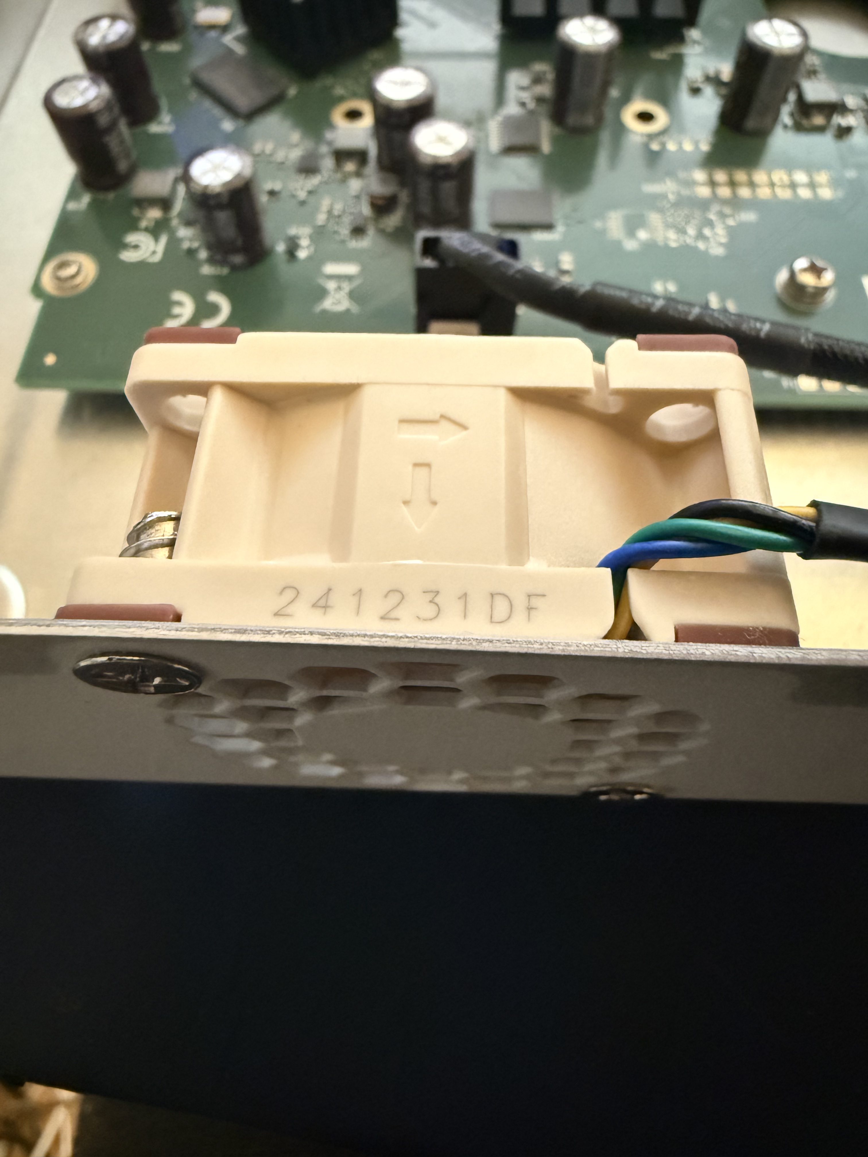

Is the direction of the new fan equal to the original fan?
“i think so” - The direction of the new fan is below pic??
I don't know what it originally was, so can't answer that.
Is the fan voltage the same as what was in there originally? what about the cubic feet per minute values?
It might pay to get the two model numbers so we can have a look if your not sure what your looking at.
As for the direction of the air flow, are there other fans in the case? You could try to revere it and see what happens.
The original fan is a Foxconn model: PIA040H12H, the replacement fan I installed is a Noctua NF-A4x20 PWM, my Mikrotik switch model is CRS310-8G+2S+IN has 1 fan only. The voltage is the same 12v for both fans. The original fan blows air external out of the unit, the replacement fan is also set to blow air external out of the unit.

Can I change a setting in SwOS 2.18 that makes the Nocua replacement fan go faster rpm? ive already tried setting the Health>Fan Target Temp (C) to: 35C and switch still gets hot.

You could try reversing the fan direction so it blows directly over the circuit board instead of sucking air over it. Just make sure the intake on the back isn’t blocked.

Could try reversing fan so it takes external air from and blows into the board but to fully test that id have to plug all ports back in and the physical area of getting the switch in and out is a challenge.

Generally speaking, blowing fresh air from the outside on the heatsinks should be (a little) more efficient than extracting air from the chassis, so, if I were you, I would try first thing reverting the fan blowing direction.

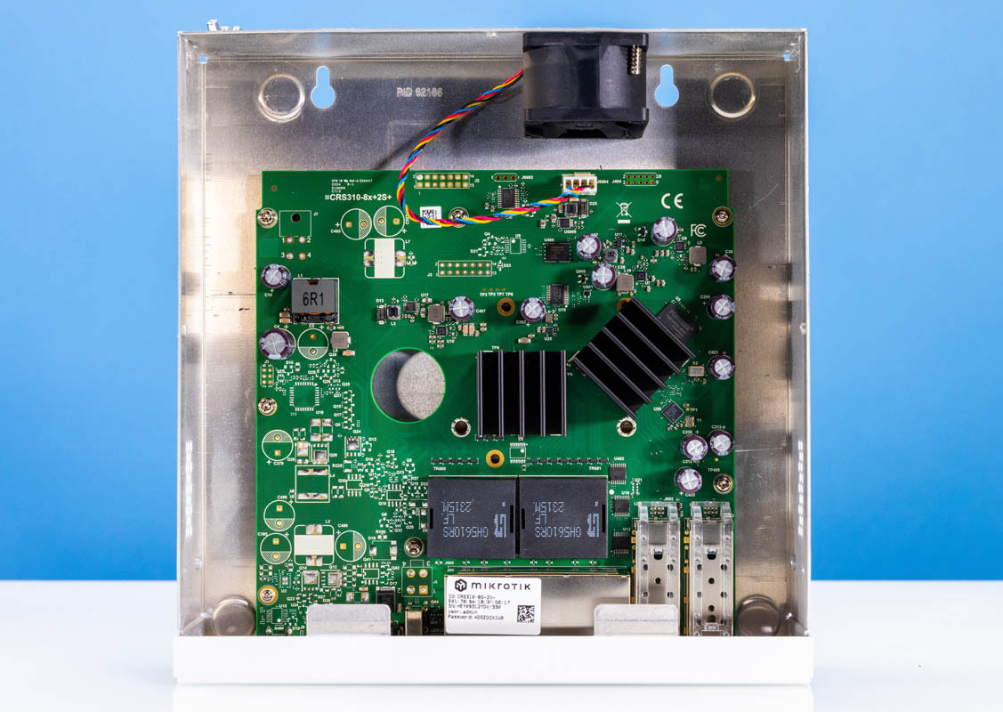

Here is a picture of your device:
The factory PIA040H12H-P17-AB is a sort of "turbo", should be running up to 18,000 RPM and deliver at least thrice (or more likely four times) what the Noctua NF-A4x20 PWM can, as it has has 9.4 mÂł/h at 5,000 RPM, using up to 0.46 W of power.

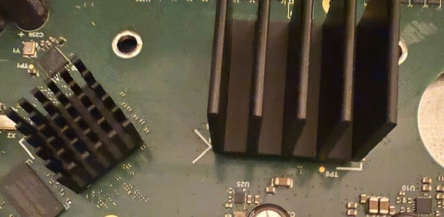

pics of my heatsinks, please let me know your thoughts, to me they look and are firmly stuck on:

The left side heatsink in your picture is much smaller than the photo I posted, that comes from:
https://www.servethehome.com/mikrotik-crs310-8g-2s-in-review-8-port-2-5gbe-and-2-port-10gbe-switch/2/
Likely a different board revision/batch (but the L signs in your picture imply that the heatsink should be much larger than what you have)
This may be a good thing as the SFP cages should get more airflow on your version.
Judging from the thermal images here (the board is still the version with larger heatsink), the chip on the left doesn't heat much, so likely the original heatsink was way too large than needed:
