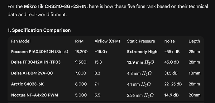

Thanks jaclaz, Comparing the fan options for the CRS310 looks like Arctic S4028 is a possible good option, Also switching to RouterOS appears to be a general safer option. My setup is 3 seperated vlans and a trunk port link.

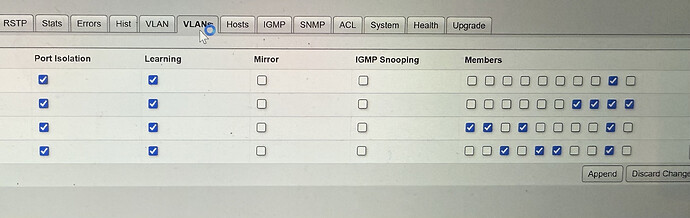

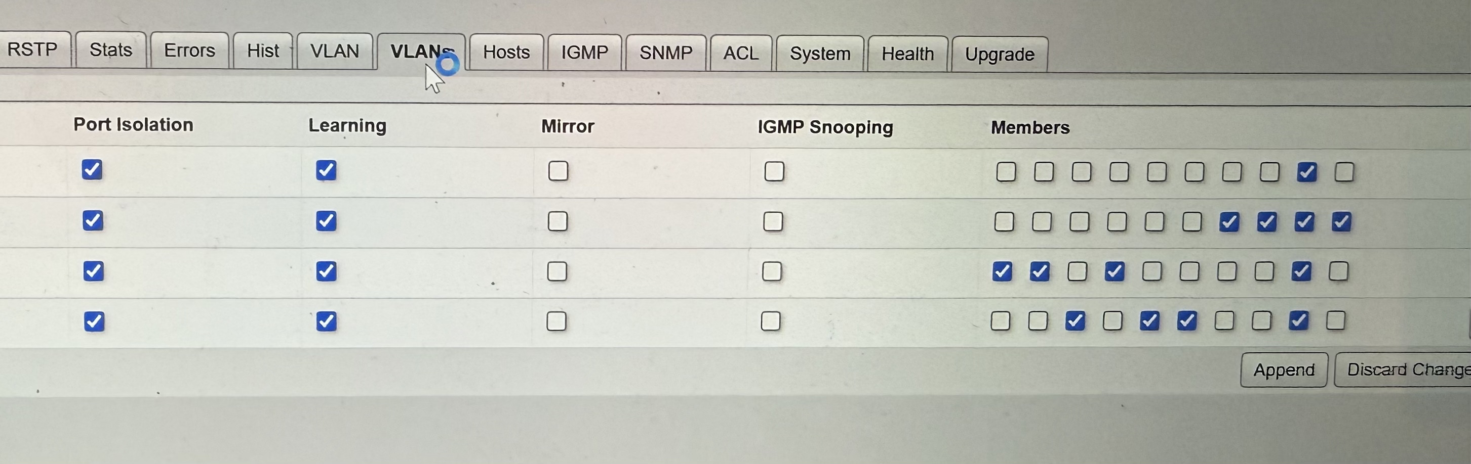

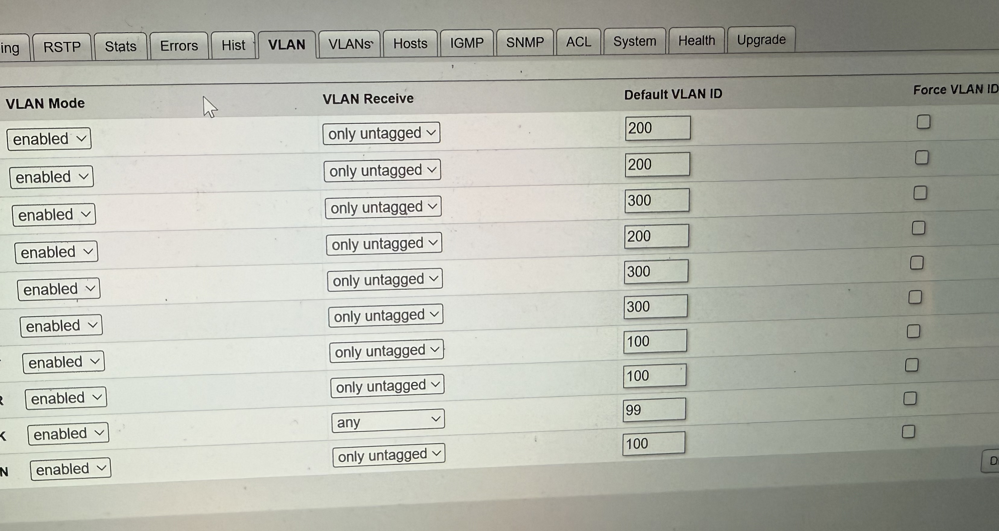

However the recreation of vlans is now an issue in RouterOS vs SwitchOS, my previous vlan configuration in SwitchOS looked like this and worked ok:
Previous VLAN tab in SwitchOS:
Previous VLAN"s" tab in SwitchOS:

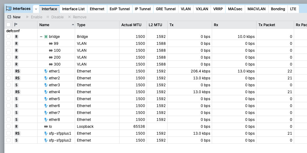

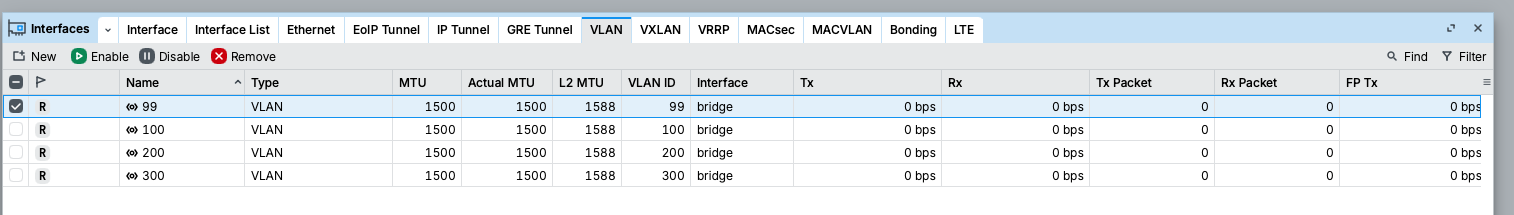

Now below trying to recreate VLANs in RouterOS, but im getting no joy in getting these vlans working again. What do I need to do to get these vlans working again??

If you can, you should take (temporarily) a port out of the bridge and VLAN's, to be used as "emergency access" in case of troubles with the VLANs settings.
At first sight what you have seems fine, but I am not an expert in VLAN settings.

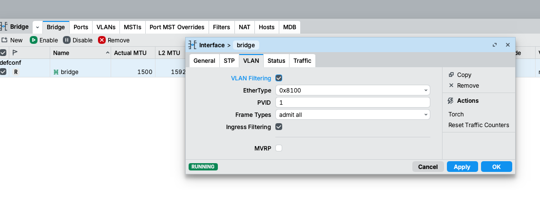

As @jaclaz said, you’re missing vlan-filtering on the bridge’s settings.
This is the config that matches your screenshots for SwitchOS:
/interface bridge vlan
add bridge=bridge vlan-ids=100 tagged=sfp-sfpplus1 untagged=sfp-sfpplus2,ether8,ether7
add bridge=bridge vlan-ids=200 tagged=sfp-sfpplus1 untagged=ether1,ether2,ether4
add bridge=bridge vlan-ids=300 tagged=sfp-sfpplus1 untagged=ether3,ether5,ether6
add bridge=bridge vlan-ids=99 untagged=sfp-sfpplus1
Also, what VLAN is your management IP for the switch? Right now it’s programmed for VLAN 1.

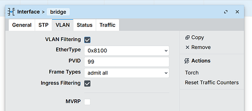

Thanks sirbryan,

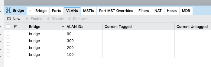

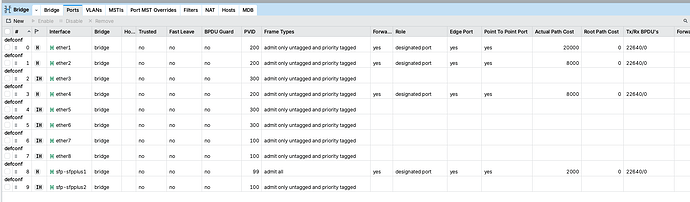

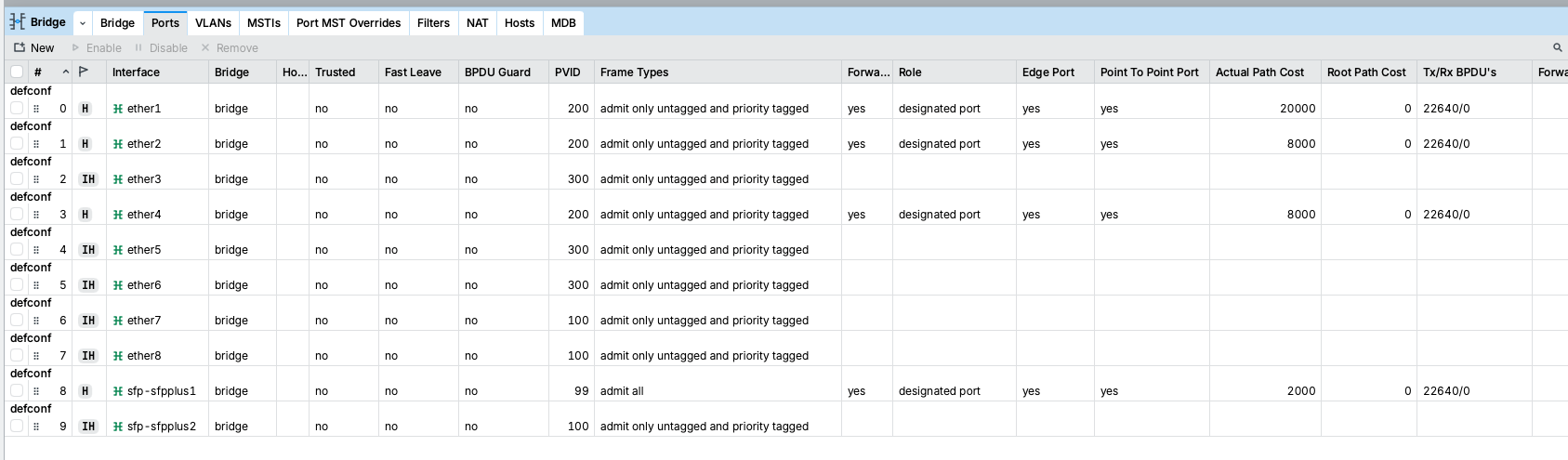

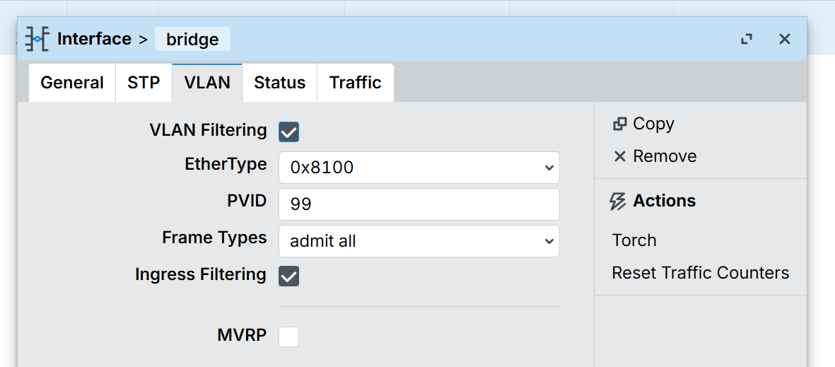

The config has been updated and now below, vlan filtering is now enabled with pvid 99:
However:
1, From Mikrotik switch (192.168.10.5) im unable to ping any hosts inside those 3 subnets ping error is: "no route to host"
2, Openwrt router (192.168.10.1 router on a stick) im unable to ping any hosts inside those 3 subnets ping error is: "Network unreachable"
I think the config issue which needs to be resolved is with the trunk port OR it could be elsewhere??

Which port on CRS is used to connect the openwrt router? Shown config doesn't have any trunk port carrying all VLANs ... sfp-sfpplus1 is tagged member only of VLAN 99 so you should be able to ping between CRS and openwrt on subnet 192.168.10.0/24
Well, maybe it is a copy/paste mistake, but that config does not contain what sirbryan suggested.
sfp-sfpplus1 is physically connected to the openwrt router, currenly there are no sucessful pings between CRS and Openwrt. What config do I need to apply to CRS via WinBox GUI so that the trunk port carrys all 3 vlans?
@mkx @jaclaz @sirbryan
think i've made the correct changes - tag sfp-sfpplus1 to individually to all 3 vlans
