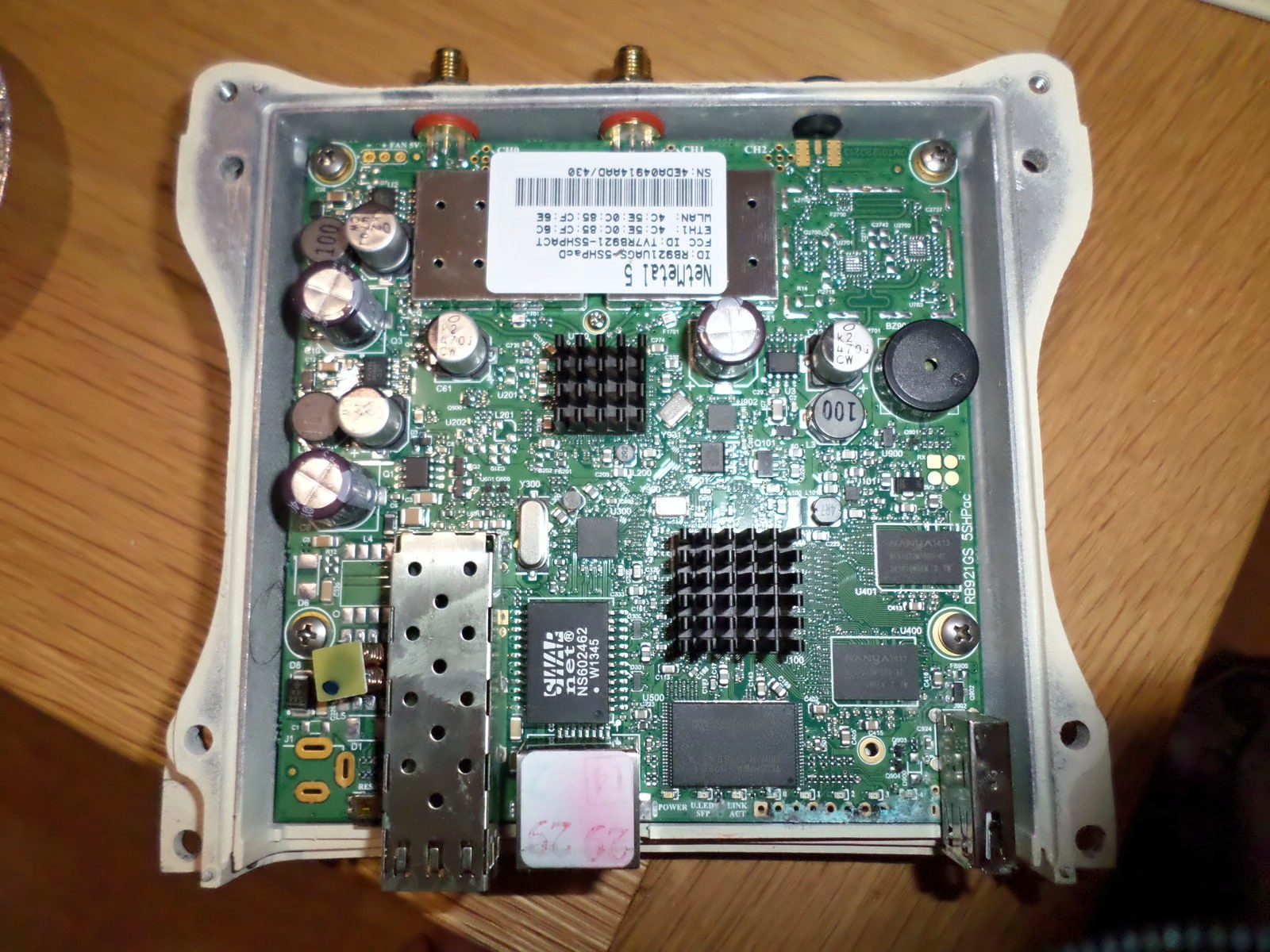

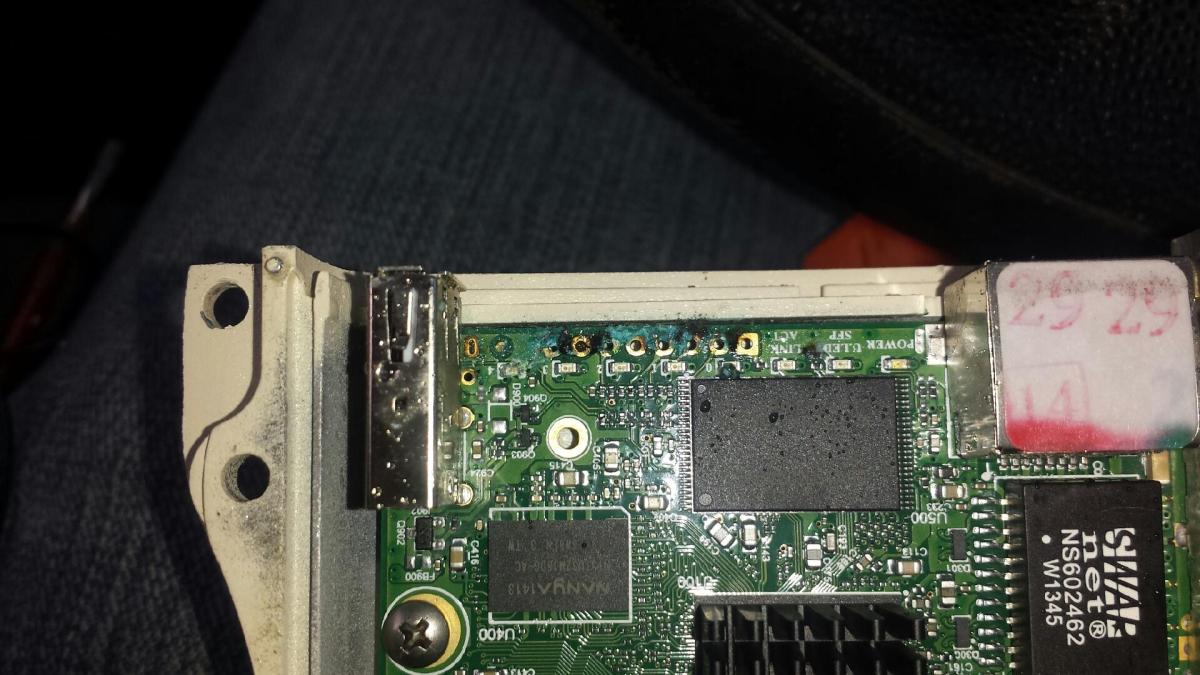

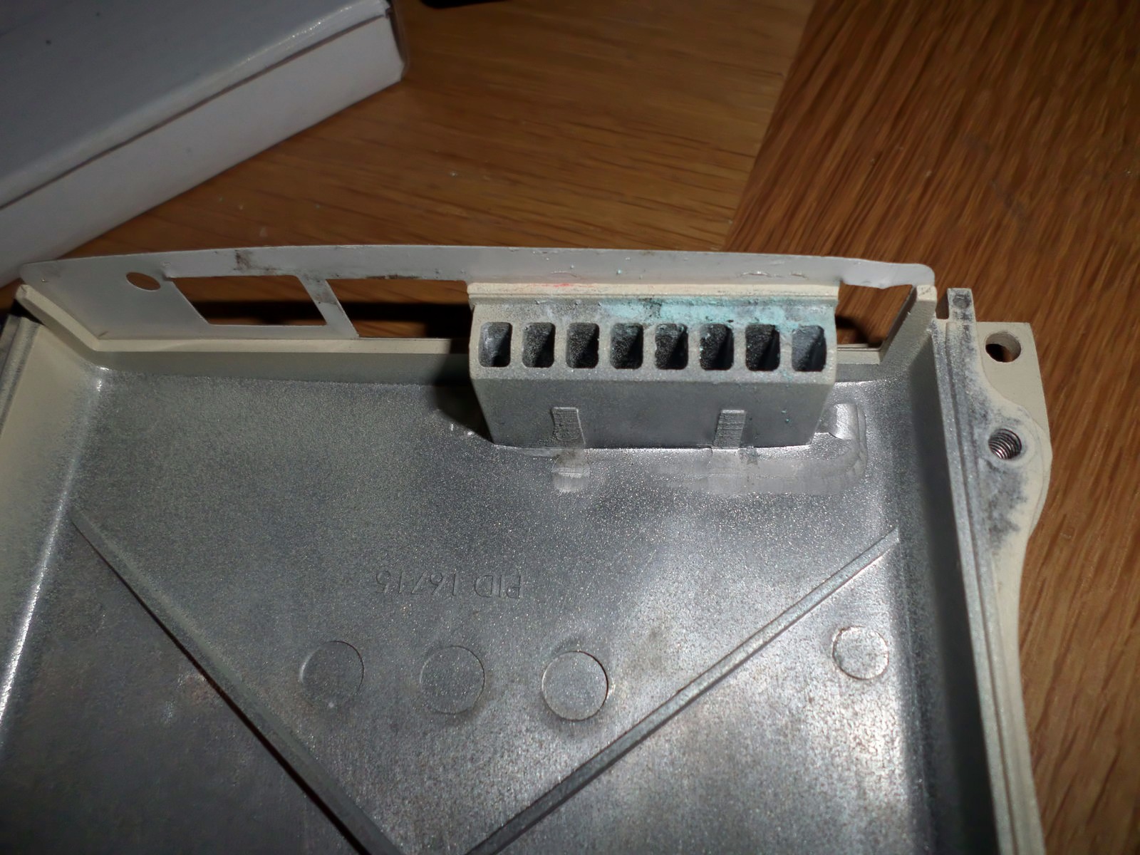

Here is a picture showing the result of the water ingress…
Please contact your reseller for RMA replacement. This should not happen, most likely this unit had a factory defect. We test the units in extreme conditions
Can you post a picture of the full device?

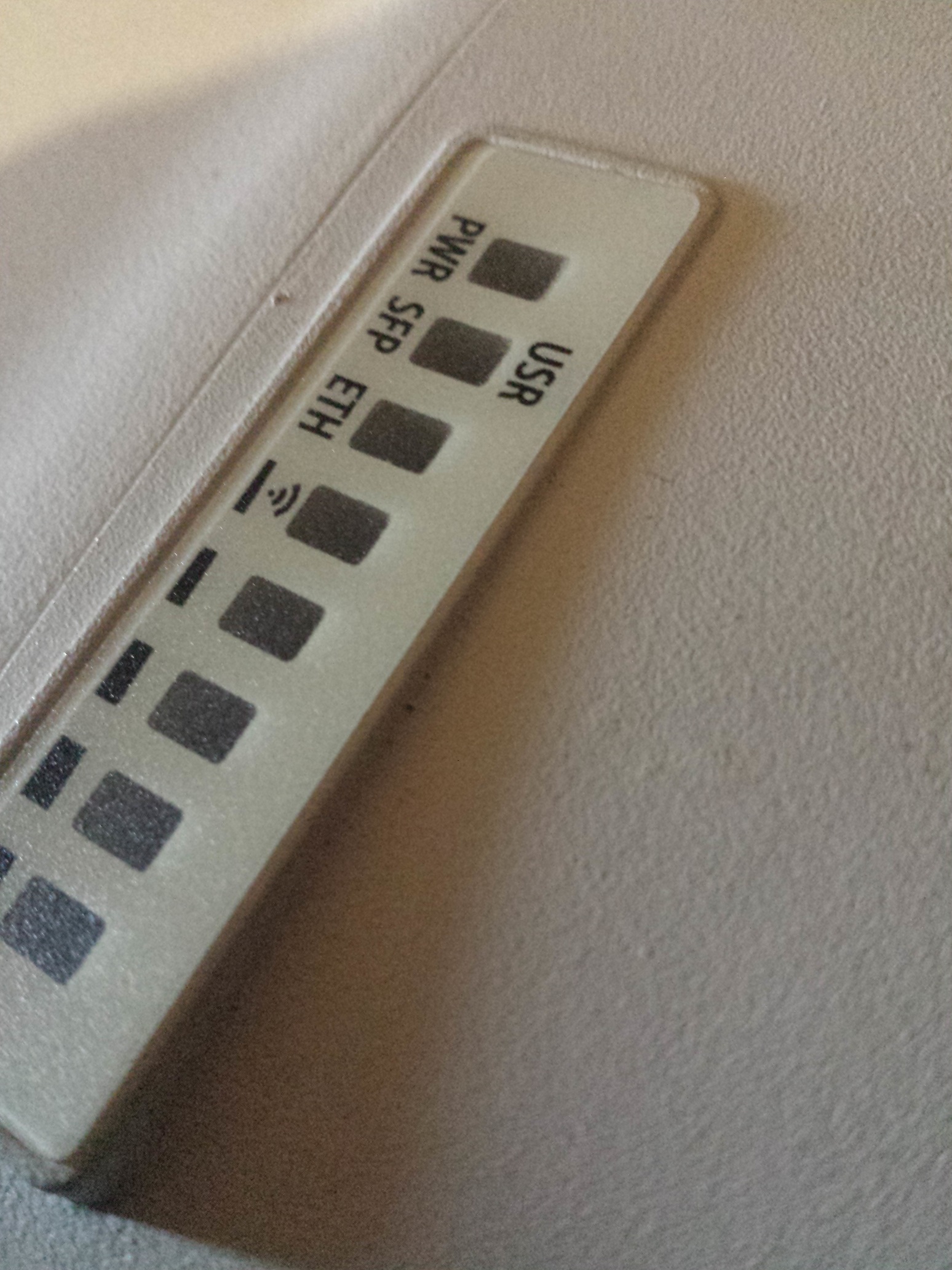

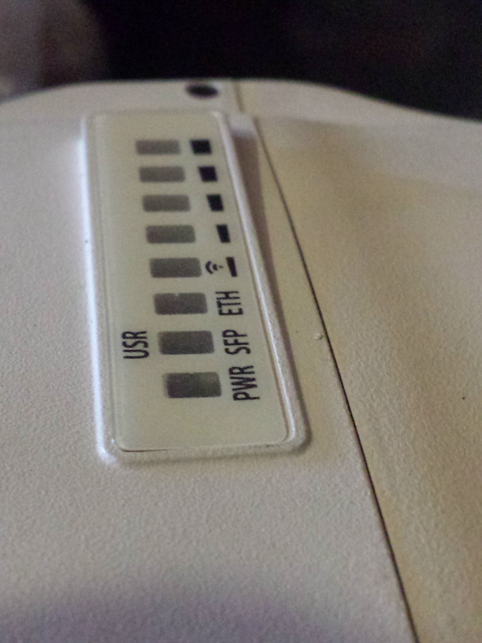

Attached are two pictures which clearly show the water damage is localised around the LED window. This is a ridiculous design flaw which I am certain other users will suffer from at some stage. In general the NetMETAL unit is a very good design - however to have a cheap sticker acting as a window for the LED’s is sheer stupidity. I saw several Groove units fail from the same location. Perhaps the Mikrotik test units were put together with more care but after a few months of being baked in the sun combined with mass production sticker placement - this is going to be a nightmare.

Can you identify where the water got in? This would be really interesting to know - especially if it was via the LED window.

could you send some pictures of bad router so we can see how it looks like. Both - the board and case (the led sticker)

I just want to add a comment from one of my technicians who has many years of experience in the field of electrical and electronic engineering. I instructed him to remove the LED sticker and fill the holes with clear silicone. He was expecting the sticker to be difficult to remove but found it came away quite easily. This is a unit that was purchased 2 months after the previous failed ones so this just confirms my suspicions - the NetMETAL units are not fit for purpose out of the box. Only removing the LED sticker and applying silicone will make these units suitable for heavy rain.

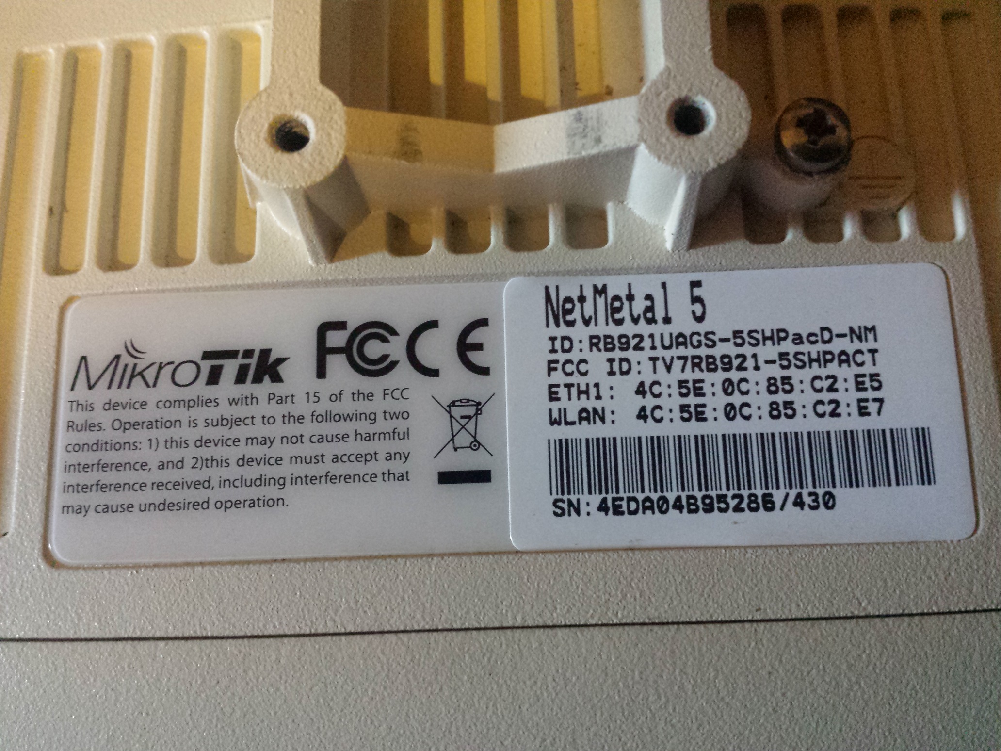

So I just got time to examine a third unit which I withdrew from service at the same location as a precaution - the attached photos speak for themselves. The serial number is shown in one of the pictures as requested by Normis. These pictures clearly show a manufacturing error and obviously is not going to be unique to any unit I purchased. This sticker is a really bad idea as only a small placement error renders the unit unsuitable for outdoor use. This is not a complete disaster once people are aware of the problem and use silicone to fill the LED window and I will continue to use the units. However future designs need to take account of this…
all the routers with this problem are eligible for RMA or silicone treatment if so you choose.

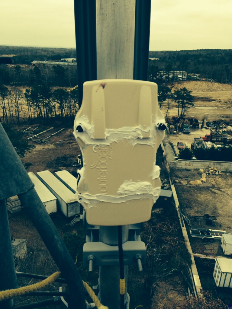

Two Netmetal 5 were in service 1 month before failure. The two Netmetal 5 that failed were in adverse conditions exposed to salt water mist . When the bottom latch was opened 3 ounces of salt water came out and the ETH/POE was charred on both Netmetal 5 units . Currently the plan is to seal all the seams and orifices with silicon until weather proof plastic enclosures can be built to house the NetMetal units.
We have had 3 failures due to water intrusion so this now my personal recommendation of weather proofing NetMetal 5 .

What is the "Silicone Treatment " ?
