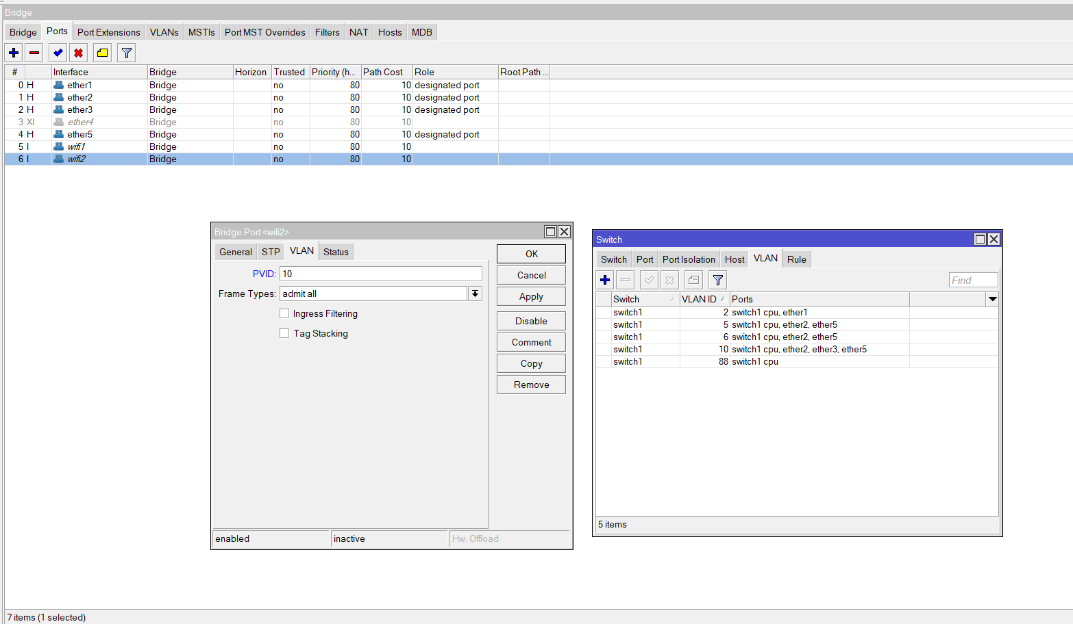

guys, can you tell me how to configure wave2 with vlan mode ?
Configure bridge with vlan filtering and add wifi interface with PVID set. You don’t have to configure anything regarding VLANs on wireless interface. One should do VLANs on RB4011 this way even if wireless is not in the mix, it is not possible to do it differrently …

my hap ac3 configured vlan with switch menu, if i configure with bridge vlan filtering, hardware offloading won’t work
i need hardware offloading to reduce cpu usage
…but you cannot configure the WiFi/Wave2 Interfaces/SSIDs VLANs in the switch menu, can you?
so, I have to wait until this feature can be used in the next update ?
no, why…you could still add the wifi interfaces to the bridge, but configure the ethernet ports via the switch menu: https://help.mikrotik.com/docs/display/ROS/Basic+VLAN+switching#BasicVLANswitching-Otherdeviceswithabuilt-inswitchchip
The wifi ports do not support hw-offloading anyway.
i’m added pvid vlan 10 on bridge port wifi2 (wifiwave) still didn’t get ip from dhcp with configure vlan on switch menu
Unless you enable vlan-filtering on bridge, all of VLAN settings on bridge ports (pvid included) are ignored.
Do you use your hAP ac3 as a full-blown ethernet switch? As already mentioned, l2hw offlload doesn’t do much unless you have considerable traffic between members of same VLAN connected to different ethernet ports (e.g. members of VLAN 6 connected to ports ether2 and ether5). If traffic is routed (between different VLANs or towards internet) l2hw offload doesn’t help.
And in case device isn’t really a VLAN switch, you can configure your device only in bridge configuration subtree and leave ethernet subtree empty. In this case wave2 wireless interfaces will work as normal access ports.
As already said, you need to use vlan-filtering=yes for the wifi interfaces to work with VLANs…but only these.
You maybe could combine things.
Use one ethX as trunk for the wifi traffic…add this ethX to the bridge only (add wifi interfaces of course).
Configure all other ports in switch menu…add a second switch, of you do not have a spare port.
yes, i need vlan 6 to forward traffic between ether2 and ether5
your suggestion work, but its sacrifice one port, need vlan option on wifiwave2, like old driver
I understand you need it. The question is about actual throughput between these two ports. My experience with hAP ac2 (which features a similar SoC using same CPU) is that device is fully capable of bridging all ether ports with VLAN configured at full speed using bridge configuration. However, it does consume a large part of CPU which would mean reducing wifi performance. However, if realistic throughput between said two ports is not that high (on average), then device should be able to perform wirespeed and have decent wireless performance at the same time while being configured with bridge vlan-filtering.
N.B.: @Hominidae suggested “hybrid” approach of using both /interface/ethernet/switch config and /interface/bridge with vlan-filtering enabled. This kind of setup is not very common (and AFAIK is not supported by Mikrotik at all), is not very well tested and might cause some unexplicable problems. So if you do go that way and things misbehave ever so slightly, this might be the problem.

i use your suggestion, and i had a problem, devices can’t connect to ap after change configuration on interface wave2, needed to disable vlan-filtering before change configuration on interface wave2
