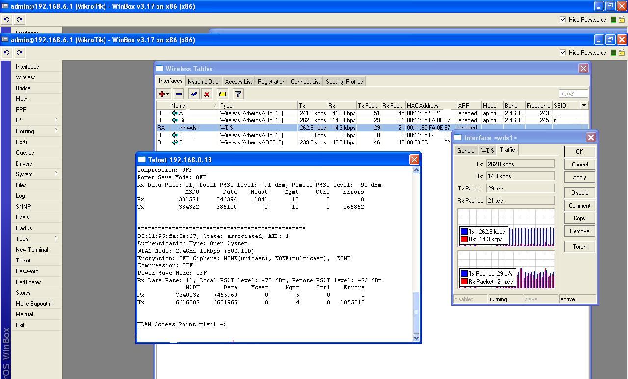

WDS work very good mikrotik 3.17 and 2100 BlueBox
Can you show your configs for dwl-2100 and Mikrotik?
yea… plz post the setup
