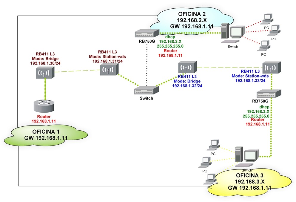

hi all,
have “problems” to communicate with differentes networks.
i make a wds-bridge between 3 offices with rb411 L3
Office A distribute to B and C :
Office A:
Mode: bridge
ip: 192.168.1.30 (interface bridge)
Gateway: 192.168.1.11
Dns server : 192.1668.1.1
Office B:
Mode: station-wds
ip: 192.168.2.30 (interface bridge)
Gateway: 192.168.2.11
Dns server : 192.1668.2.1
at office B put other wds bridge to office C, because A to C NLOS (no light)
The bridges are ok and working brinding internet, but i can not make a ping office 2 to 1 and office 3 to 1 and 1 to the others office.
I had reading about masquerade, vlans, vpn,
What do you sugget me ?
Thanks all
Thanks all
I have tryed wds + tunnel and wlans, but the rb like brige doesnt work now, i can not access by web or winbox, lost pings and its imposible to get in configuration.
thx.-----

Hi guys,
Well, no all woks 85% :slight_smile:
I have done wds-bridges , and them i have configurate rb750GB with Wan office 1 and Lan office 2 or 3.
Have ping to external, ping to 1 from 2 and 3 but i can make pings from pc's at office 1 (central) to others at office 2 or 3, Why?
i put routes on rb750G and on my router
rb750G:
Wan 192.168.1.33 Ether 1 - gateway 192.168.1.1
Lan 192.168.2.1 Ether 2 with dhcp
thnx, I'm still and still looking for information -
Any suggest????
put route on my router
Dest=>192.168.2.0 subnet mask 255.255.255.0 => Defaul GW 192.168.1.33 (rb750 ether1 ip)
I
Pc on lan 1 can´t see office 2-3
