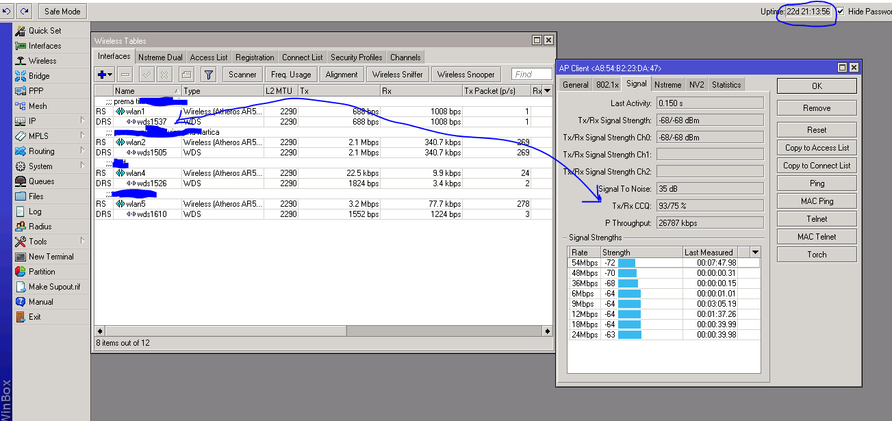

Can someone explain to me, which setting should I put to avoid these problems. Since I upgraded all my routers (RBs) to latest ROS v6.x I have problems with WDS, because it disconnects all time every few minutes. 90% of these wds links are my p2p from AP to AP and all of them are pretty good and stabile links -60dB - -70dB, and around ccq: 80-100% like on picture below. I started to upgrade routers 3 months ago and now when all are on latest 6.18 ROS, I see that I have these problems all time.
On picture You can see one p2p link on 802.11a 17km with 27dB grid antennas -68/-68dB and ccq 80%
You can see that router has 22 days uptime and over 1000 WDS connections and disconnections.

Grid is quite good for us for some links, but we use all kinds of antennas.
Hardware are 433AH and r52 cards with 802.11 or nstream.
Frequences are not close, area is not noisy.
Problem is that this link and few other links were working good for few years..and now same cards, protocol, antennas having this problem.
