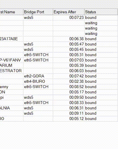

The hint. When I checked the DHCP server Leases I noticed a strange behaviour. The bridge port for the Yamaha Speaker connected to main router via wlan2.4 was changing repeatedly from wlan2.4 Virtual Interface (the name of this interface is “music”) to WDS2. I turned off the 1 AP and 2 AP (with WDS) and the problem with interrupted sound in yamaha speakers disappeared. But of course I want to use them (1AP and 2AP) to distribute the network to other area of the house.
What is wrong? Is somehow WDS Interfaces interfere wrong with main bridge?

I managed to capture the problem (attachment). I suppose it is a “normal” behaviour in my setup but of course - unwanted :slight_smile:
What should I do?
