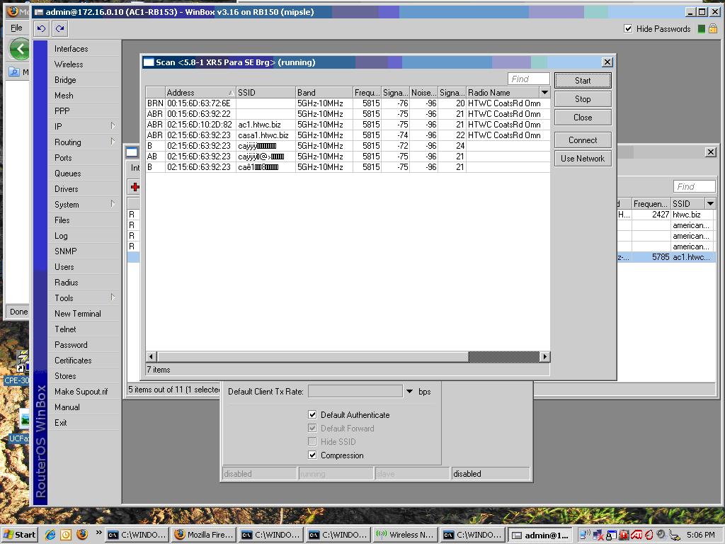

OK guys - since no one had a comment here.
And since I was getting desperate - I decided to recheck all connections from the client side of the bridge backhauls.
This is what I found - I have never seen this and it it only visible running a scan from the the edge towers.
Would like to know what caused this.
Thank you,
Rod
BTW - once I had rebuilt the wlan from scratch - the problem was resolved
I am not able to see the same issue with other cpe - only MT - but if the corruption is on any interface - 2.4 or 5.8 - it causes the entire board to function erratically.
