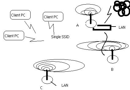

I’m in the process of setting up a few AP’s in an area and I’ve been told that using WDS will probably be the best solution.
This is what I’m faced with:
Brief explenation:
Router A is connected to the Internet and running a LAN - SSID=mtSSID
Router B is connected to A via LAN on high site - SSID=mtSSID
Router C is on distant high site - SSID=mtSSID
I want my wireless clients to connect to any of the three AP’s. What I understand under WDS is that it makes your AP act as an AP / Client at the same time. This to me means that router C will broadcast the SSID, making it possible for some one standing in the left bottom corner of my image to connect to router C and thus getting access to the internet (and both the LAN’s if indeed I wanted them to).

Do I understand WDS correctly? Cause if I do - why does my laptop still connect to B in stead of C?
