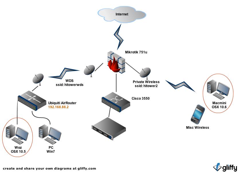

Having connectivity issues between a 2 Macs, one is on the other end of a WDS connection the other is connected to virtual AP; specifically doing iTunes sharing, etc. I I connect both systems to the virtual wireless network everything works fine. I apologize if this is obvious.
  • Mikrotik 751u
  • WDS link to Ubiquiti AirRouter
  • See attached diagram
