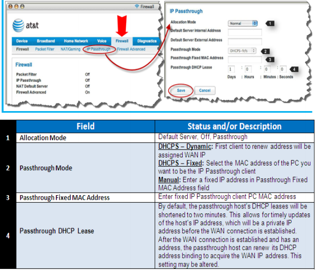

Some modems in Ip passthrough mode seems to use a trick to enable two DHCP servers (local and wan) in the setup. In this case :
A reduced (two minutes) dhcp lease time is assigned to the modem local DHCP server. When there is no wan connection, a local IP address is delivered to the client host to allow for modem administration.
When wan connection is active, the modem local DHCP server is disabled (i suppose) and the client host can get a wan address and gateway, this time delivered by the wan side DHCP server.
See here : https://www.att.com/gen/general?pid=23697
