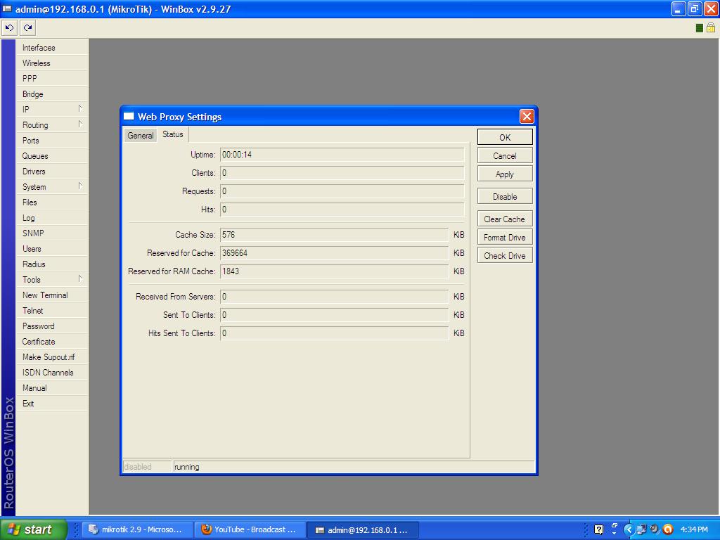

yes i’ve done as you said in above mentioned posts.
but still cache is not working or increasing in web proxy status.
see the attached picture
You are using an obsolete version of the OS. You should upgrade to at least version 3.30 or higher.
