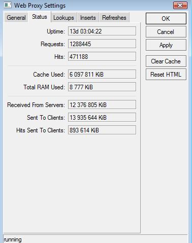

Hi there,
I am hoping that somebody can explain why the bottom three values don’t seem to add up.
Shouldn’t “Received From Servers” + “Hits Sent to Clients” = “Sent To Clients”?
On my example:
12 376 805 + 893 614 = 13 270 419 and that is not equal to 13 935 644.
Can somebody show me where I am going wrong?
you are not going wrong at no place. but aren’t you running any filter rule ? aren’t u droping packets somewhere?
Yes we are blocking a few sites and also preventing external access to the proxy. But the sites are blocked on the outgoing route already and I can’t see how that could amount to about 700MB of traffic.
i jsut made a simple calculation from my side and the numbers are 100% exact…
paste your filter rules there should be a trap somewhere

are you using parent proxy or just mikrotik’s proxy?
i suggest you use /ip firewall filter to drop what you want to drop
in all cases i beleive your webproxy is working properly and there is a small trap somewhere
if you have public ip on ur mt i would connect with a read only user to check it out
We only use the MT proxy. We have a separate set of rules in the firewall which governs all connections and not just web proxy rules. It would not be practical to move all of these rules to the firewall section.
If the rules were the problem it would make sense to me that “Received From Servers” + “Hits Sent to Clients” exceed “Sent To Clients”, but this is not the case. Somehow more data is being sent to the clients than received from servers + cache.
