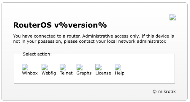

I’m sure that I’ve seen this before years ago, but I can’t remember what I did to remedy it. This happened with very old MIPS MikroTik with 7.18.2 update (started from 7.1 and actually this happened already in intermediate 7.12).
Any help? I really don’t wish to factory reset the router.

This is actually what puzzles me. I’ve seen this and I think it was a browser issue. This time:
  • I’ve cleared cache, tried 3 different browsers.
  • Did that.
  • Did that multiple times and of course also updated routeros.
  • Last wait was 12 hours.
  • First it was https, but since I can log in with ssh, I enabled http and same happens with that.
Somehow I think this must be a browser or connection side problem, but I just can’t figure out how. I can access all other Mikrotiks in my realm of influence normally with these exactly same browsers and connections.
