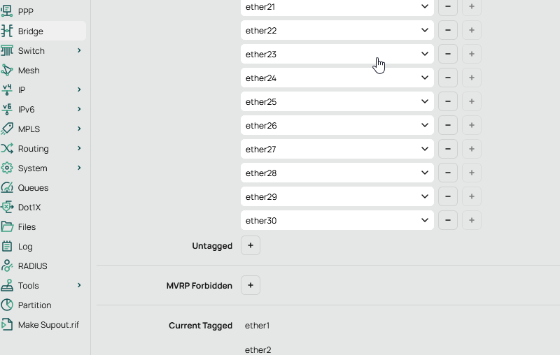

When configuring VLANs through WebFig, in the Bridge VLAN table, I can add ports to the Untagged list normally at first.
However, after adding approximately 30 ports, the "+" button becomes disabled (greyed out) and it is no longer possible to add additional ports to the Untagged list.
Expected behavior:
It should be possible to add all required ports (up to all 48 switch ports if needed) to the same VLAN as untagged members.
Observed behavior:
  • The issue occurs only in WebFig.
  • WinBox does not have this problem and allows adding more ports.
  • The configuration itself appears to be supported by RouterOS.
  • This looks like a WebFig UI limitation or bug rather than a VLAN or hardware limitation.
Additional information:
  • CRS354-48G-4S+2Q+RM
  • Issue reproduced consistently in WebFig.
  • WinBox works correctly with the same configuration.
