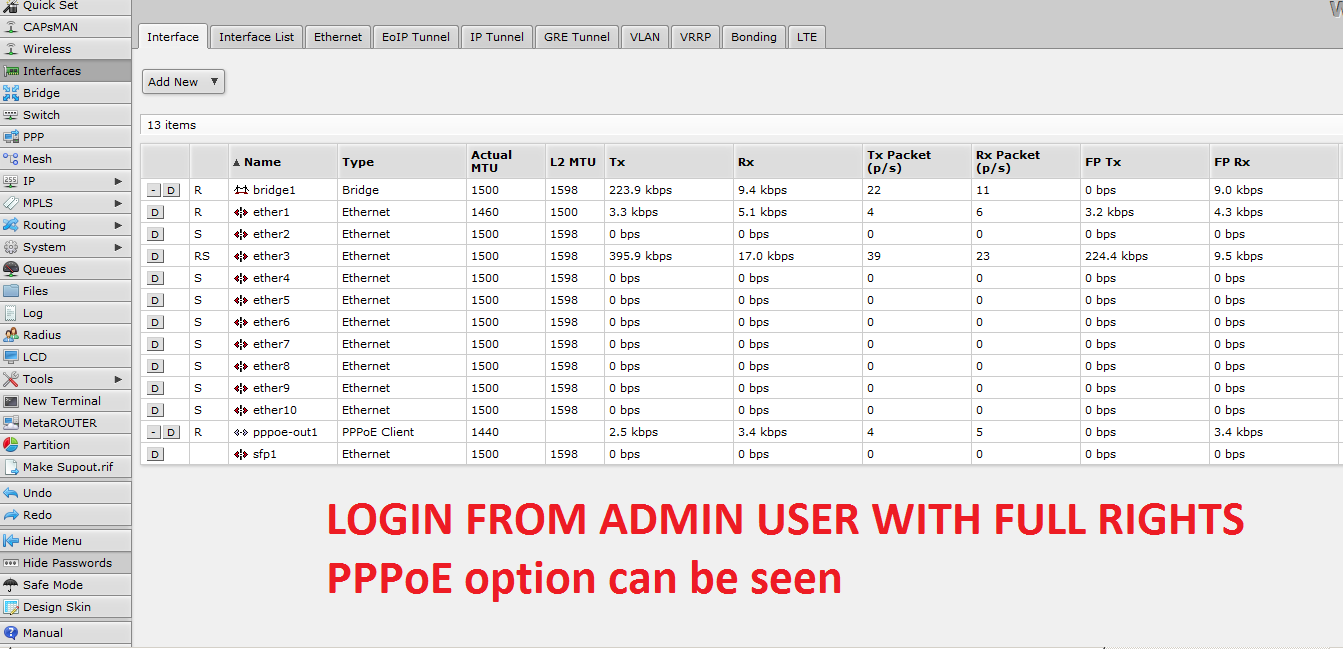

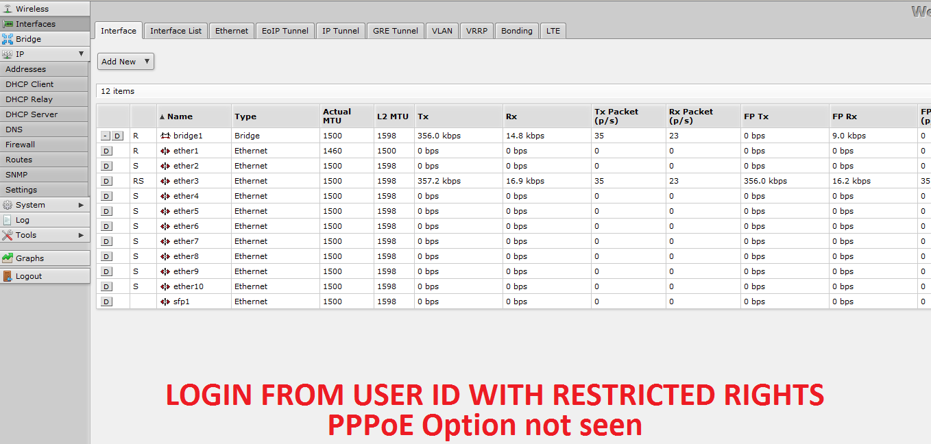

when i login to the Webfig through a User credentials who has restricted rights why can’t i see the PPPoE interface??
