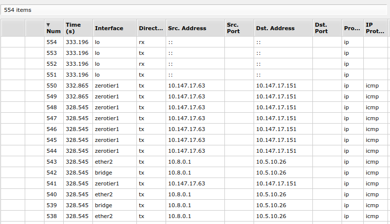

I just got my hEx and powered it on.
I upgraded it to latest version and also tweaked it a little bit.
From WebFig, I went to “Tools → Packet Sniffer” and initially could see the IP addresses and ports etc.
But now, all I see is only the remaining (without the IP addresses/ports) - see image:
How do I get the full info for every record?
I think that there’s a bug:
The Raw Data of each record/packet contains the IP address, but it isn’t being shown in the record.

RouterOS v6.47.8.
Could you please fix this?
I can confirm this issue on RouterOS 6.48.3.
Currently, the web UI of the packet sniffer is simply unusable due to the missing fields.

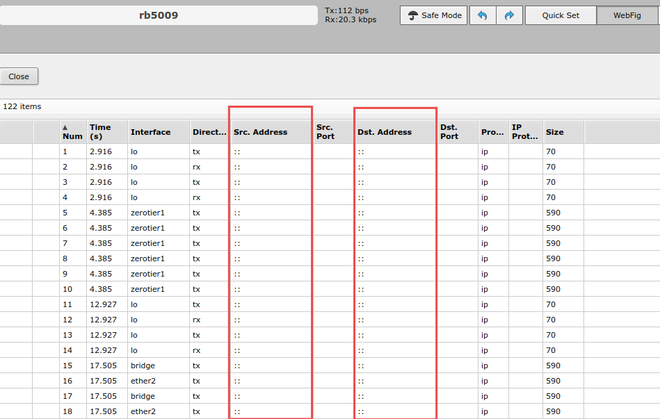

Sorry for necrobumping but is seems that it’s still the issue in
7.15.3
I’ve found that as soon as I execute from CLI:
/tool/sniffer/packet/print follow
SRC and DST addressees are displayed in WebFig
