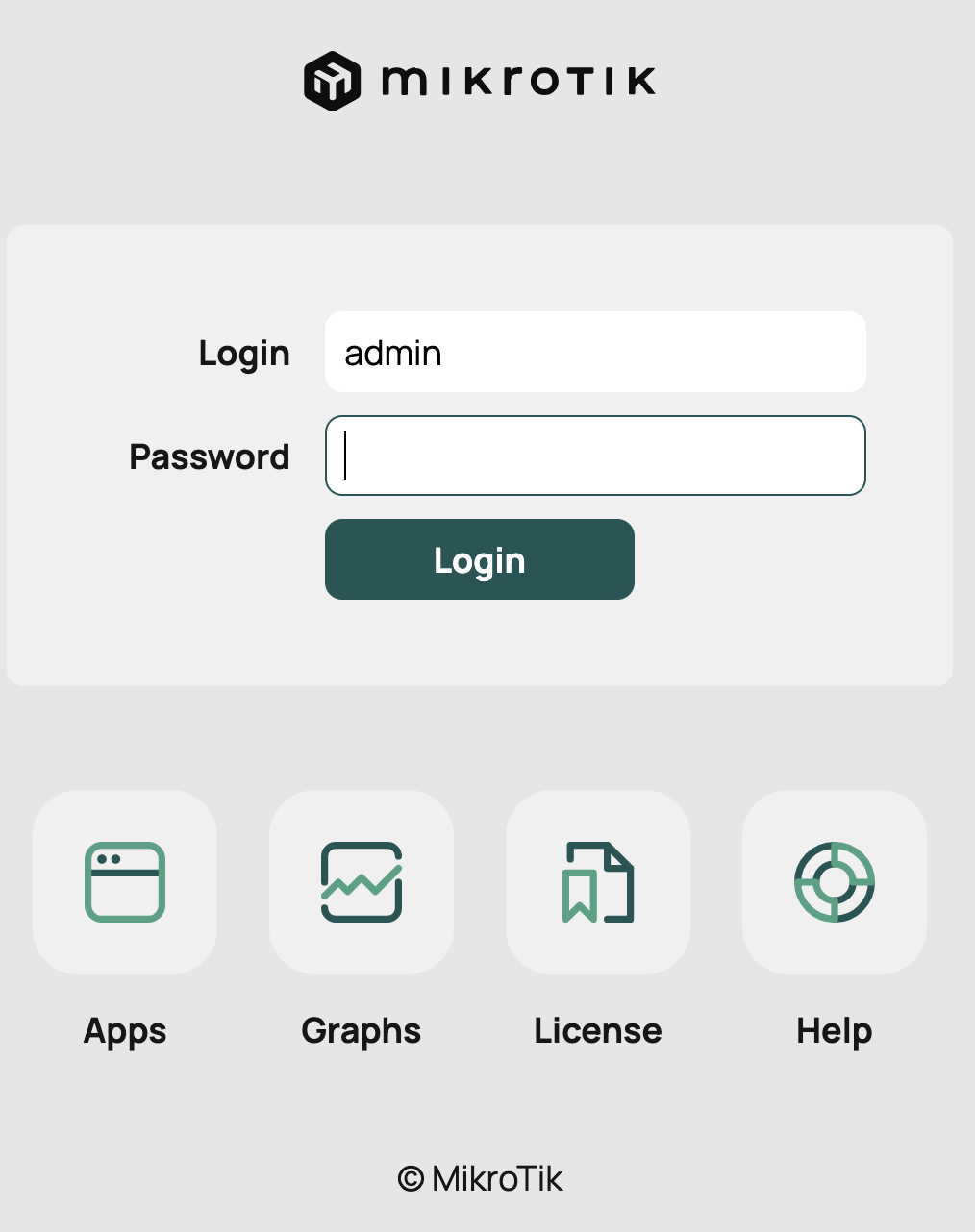

WebFig came up with this login window with the address 192.168.88.1

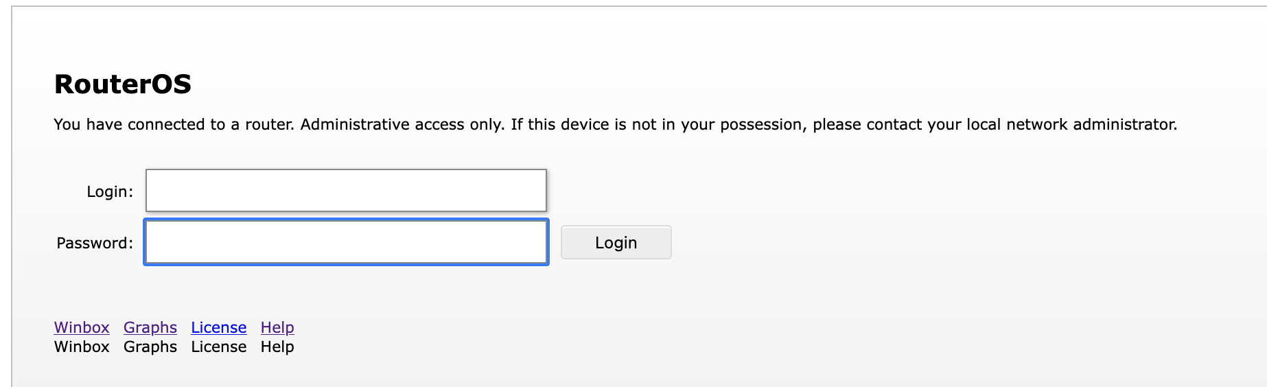

When I logged in, it came up with this window
Logging into the second windwo got me logged in to the router with QuickSet in the display. When clicked the advanced topics tab, it took me back to the login in the second screen.
Logging in there took me to the first screen. Then it said my password did not match. General mess.
So I did a reset on all the routers. On the hEX 192.168.88.1 gives me the first login window, then the second gets me logged in. The address 192.168.88.1/? takes me directly to the second window, where I can log into the hEX. The default settings have given me wired internet. But I cannot connect to the AX3s at all after they were reset. So I have a wired internet connection, but no WiFi.
