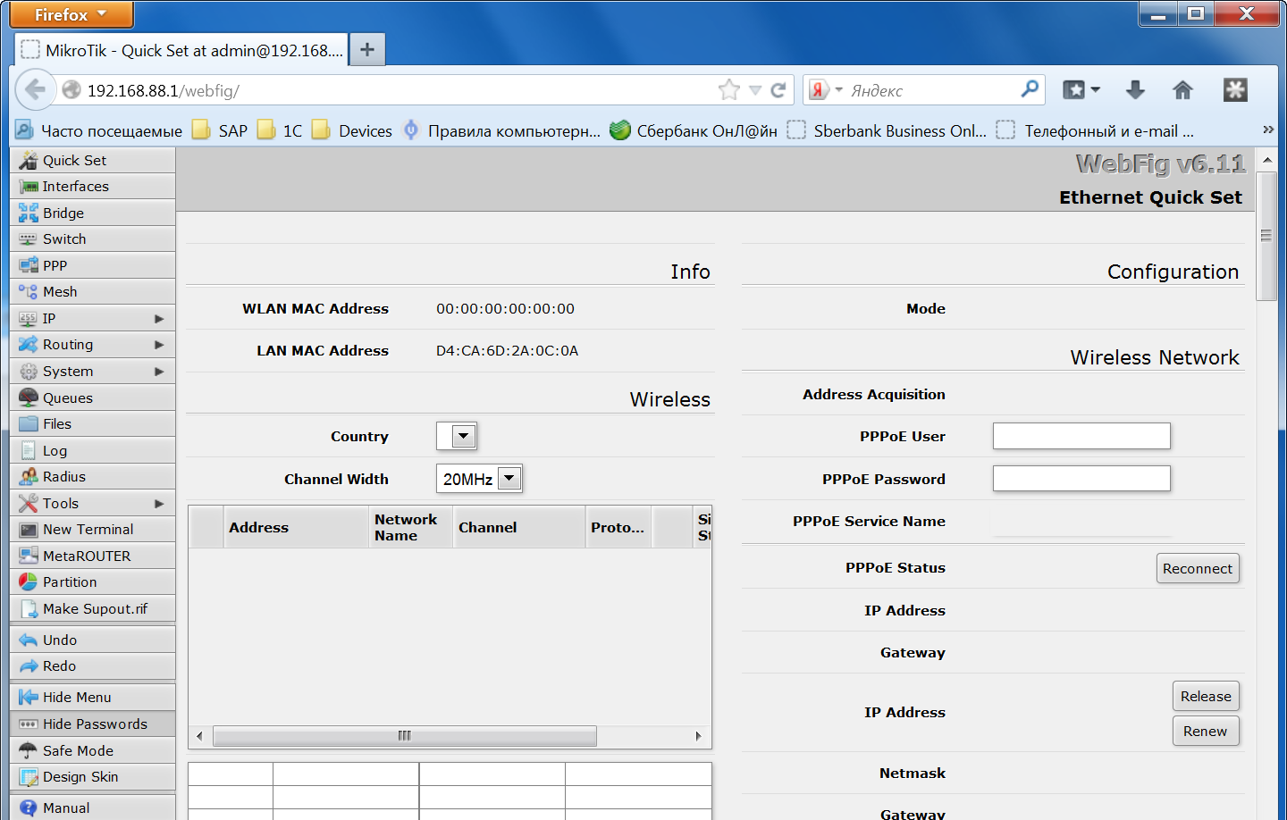

Recently upgraded my home 751G-2HnD to 6.11. Today logged in using browser (usually prefer WinBox) and found out, the Quick Set page is corrupted. It seems like page blocks are repeated several times and not filled with data at all. Even more strange, it contains Wireless part, while corresponding package is disabled in my router. At the same time, in WinBox quick set page looks just fine.
Tried different browsers, and both Mac OS and Windows. In WebFig Quick Set is corrupted everywhere.

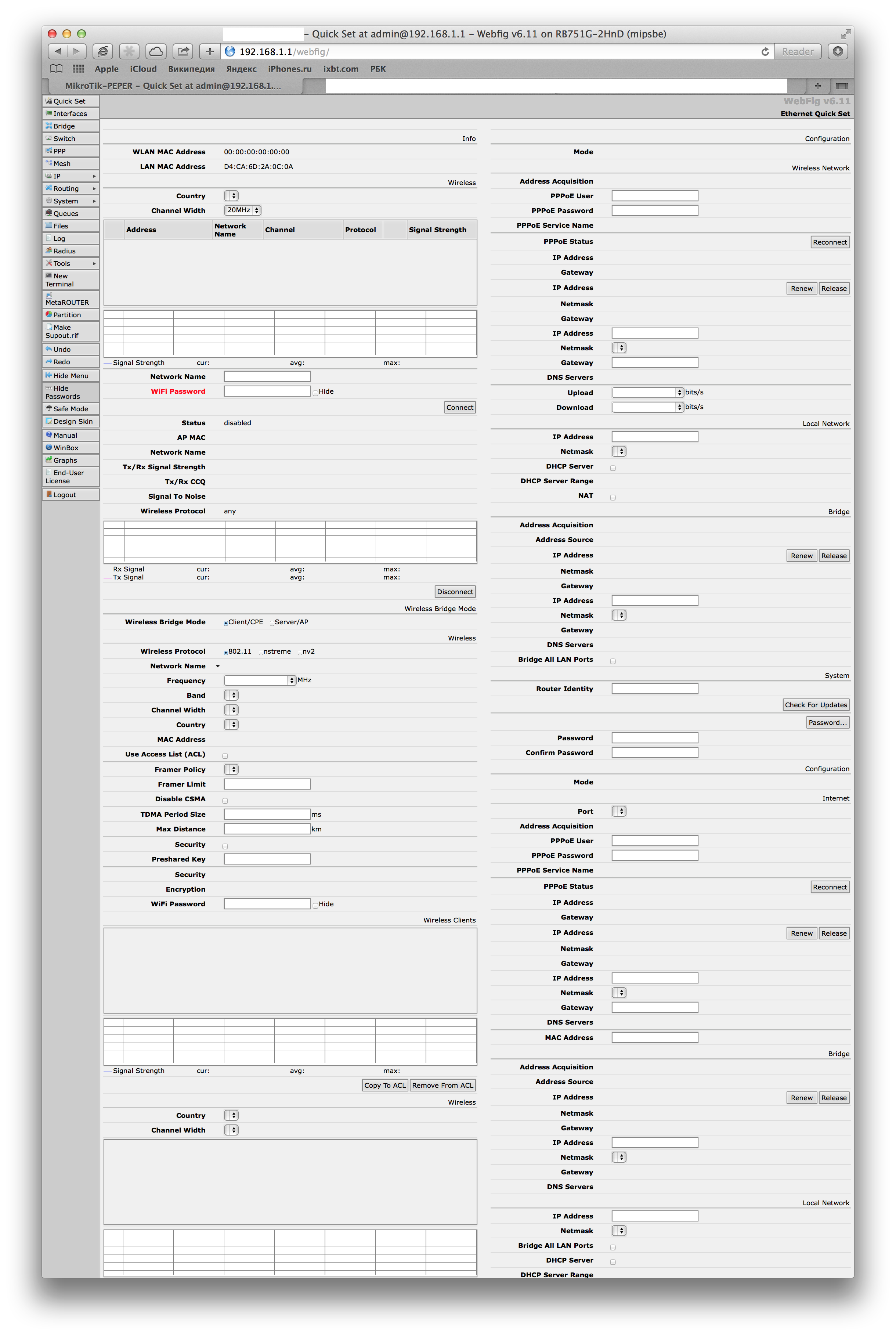

Also found out, that on problematic configs “Quick Set” button in the menu is not activated (“pressed”). See screenshot below.

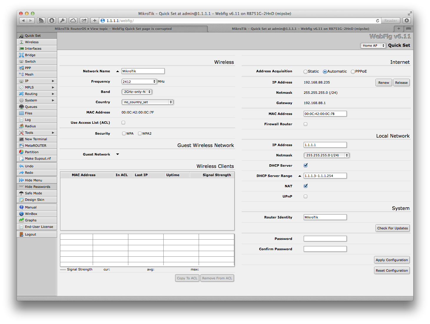

I have tried different devices now, there must be something specific in your config. Which QuickSet mode did you use before upgrade? Did you also configure something else in v6.10 apart from Quickset? What packages do you have installed?
Here is mine:
You are right about the packages. It took me couple of hours of experiments to find this out.
As I have separate WiFi AP in place I decided to disable wireless package in Mikrotik some time ago. And this is what causes problems now. If I enable it - interface is shown correctly, disabled - and having problems. On 6.10 its ok independently of wireless package status though. Please, ask your devs to look at web fig code - maybe it somehow analyses the existence of wireless device and corresponding package and its status.
