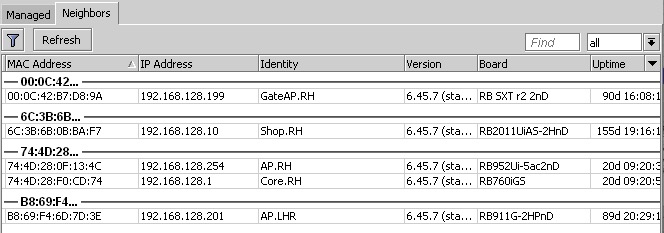

That’s interesting. I get no MAC addresses in the list, but they show up right away if the router has an IP and MAC. So I cannot configure any router that doesn’t have a default config.
Actually, for illustration purposes, I probably should not have used the ROMON window, but the standard Winbox neighbors window:
If a router has no IP address defined, the MAC address still shows up here, but the address is 0.0.0.0. You can still do a MAC login.
Note that I am using version 6.19 here because the Winbox versions released over the past few months are so generally infested with new interface problems that I have all the grief I can manage wrestling with my Windows version I have already updated, I didn’t want to pollute my Mac version as well. It’s possible the behavior you are seeing is yet one more interface problem with one of the more recent versions.
