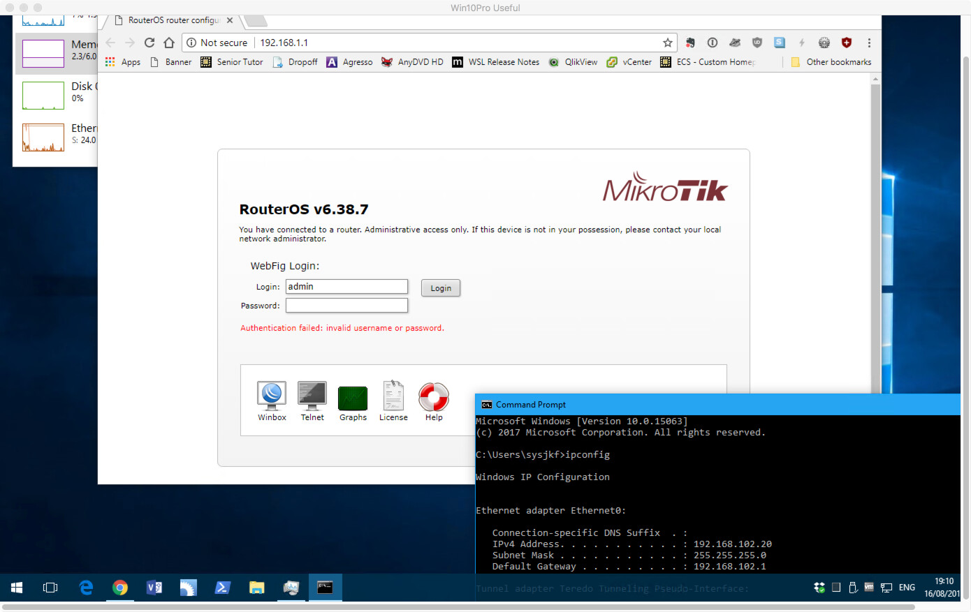

And another thing that’s broken: if I attempt to login to my router via ssh or www from any subnet other than the small original private class C (192.168.21/24), I always get the error “Authentication failed: invalid username or password”. Always. And if I log in from my original 192.168.21/24, it always lets me in.
Attached are screenshots showing a failed login (with proof of the client IP address), and one showing the (slightly redacted to protect the innocent) output of “/ip services print detail” clearly showing the network 192.168.0.0/16 in the list of allowed networks.
Exactly the same password rejection happens for both www and ssh. Every time, 100% reproducible.
I even power-cycled the router before doing that test. It made no difference at all.

Found my mistake on that last one (the login problem).
I had checked all the /ip settings for anything relevant, I had totally forgotten this is controlled by an ACL in /users.
Sorry!
