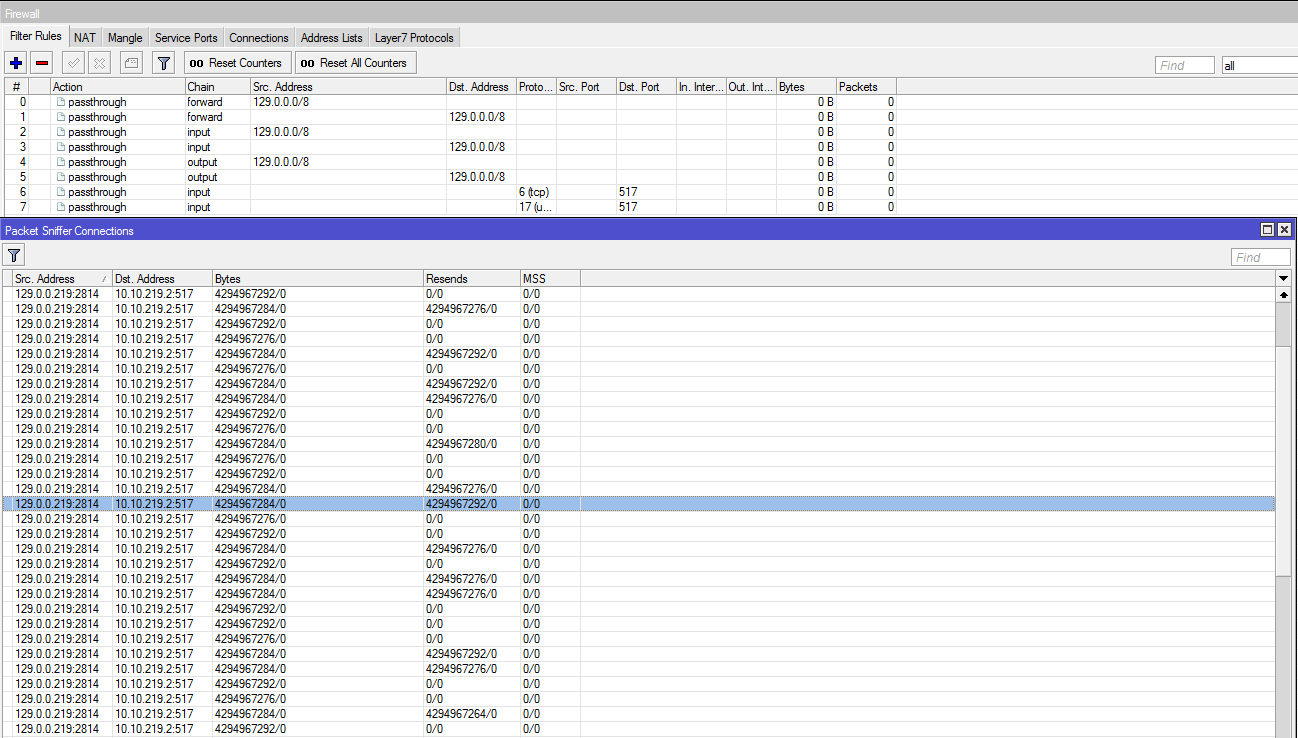

Valid IP address range would not explain why those packets do not get picked up by any firewall filter nor can I see those packets within wireshark.
I suspect that someone has two concurrent connections to Internet: one with your LAN and the second with eg. LTE and parts of LTE traffic is “leaking” to LAN interface.
The bytes counters are incredible - 4GB - and I run the sniffer only for approx 5 seconds each time (I am using PtP to connect to VLAN, around 40Mbit/s)

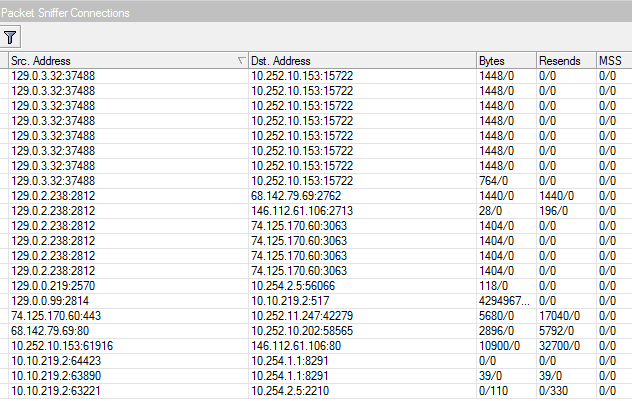

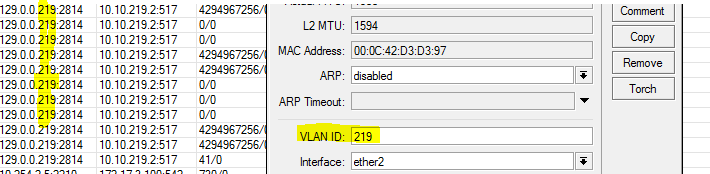

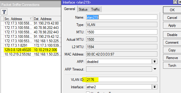

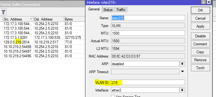

When I change VLANID, Src Addresses 129.0.x.x changes in captured connections, as long as existing connect exist prior to switching to none existing vlanXXX – ?
What is 10.10.219.2 device ?
it is the local IP address assigned to vlan219.

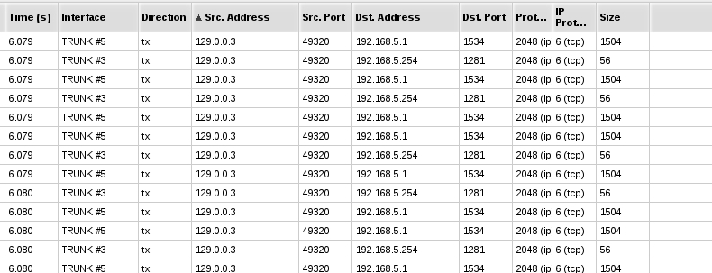

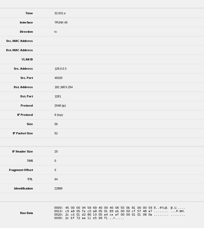

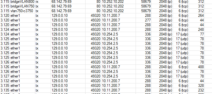

I was debugging my configuration with the tool “Packet Sniffer” from 2 routers “RB2011UiAS-2HnD-IN” with the OS 6.37.1 and I found myself seeing similar traffic. In my case the source IP is always 129.0.0.3. The weired part:
  • The direction is always TX.
  • I can’t see the traffic on the destination addresses (sniffing with tcpdump on the destination host).
  • I can’t see it entering the routers.
  • In one router the traffic is always TCP on the other is always UDP.
  • It happens on interfaces that are used as TRUNKs but the packet is on the parent interface and not in any of the VLANs.
I included the raw data of one of the packages. I see similar raw data on a valid traffic between a PC and a IP camera.
I hope this help to solve this problem.

I’ve weird 129.0.0.vlanid packet broadcasting inside the vlan. Sometimes when users need more network ressources, the flow can gros as the consumed bandwith. Sometimes i had above 10Mbits/s or 20Mbits of weird traffic.
It doesn’t get caught by firewall and not visible in wireshark.
It’s not internet flow cause we disabled internet interface while rebooting router and switch.
If someone have new info or tips,…
regards.
