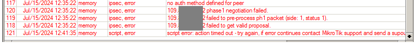

1, First of all - sometimes Mikrotik kicks out users and when it does, users are not able to reconnect until L2TP interface is disabled/enabled on ROS.
 07-15 14:30:54 ipsec,error no auth method defined for peer
 07-15 14:30:54 ipsec,error 37.x.x.x failed to get valid proposal.
 07-15 14:30:54 ipsec,error 37.x.x.x failed to pre-process ph1 packet (side: 1, status 1).
 07-15 14:30:54 ipsec,error 37.x.x.x phase1 negotiation failed.
 07-15 14:30:58 ipsec,info respond new phase 1 (Identity Protection): 84.y.y.y[500]<=>37.x.x.x[30554]
 07-15 14:30:58 ipsec,error no auth method defined for peer
 07-15 14:30:58 ipsec,error 37.x.x.x failed to get valid proposal.
 07-15 14:30:58 ipsec,error 37.x.x.x failed to pre-process ph1 packet (side: 1, status 1).
 07-15 14:30:58 ipsec,error 37.x.x.x phase1 negotiation failed.
 07-15 14:30:59 ipsec,info respond new phase 1 (Identity Protection): 84.y.y.y[500]<=>37.x.x.x[30554]
 07-15 14:30:59 ipsec,error no auth method defined for peer
 07-15 14:30:59 ipsec,error 37.x.x.x failed to get valid proposal.
 07-15 14:30:59 ipsec,error 37.x.x.x failed to pre-process ph1 packet (side: 1, status 1).
 07-15 14:30:59 ipsec,error 37.x.x.x phase1 negotiation failed.
 07-15 14:31:02 system,info L2TP Server settings changed by tcp-msg(winbox): (/interface l2tp-server server set accept-proto-version=l2tpv2 allow-fast-path=no authentication=mschap2 caller-id-type=ip-address default-profile=vpn enabled=no keepalive-timeout=30 l2tpv3-circuit-id="" l2tpv3-cookie-length=0 l2tpv3-digest-hash=md5 max-mru=1450 max-mtu=1450 max-sessions=unlimited mrru=disabled one-session-per-host=no use-ipsec=yes)
 07-15 14:31:07 system,info L2TP Server settings changed by tcp-msg(winbox): (/interface l2tp-server server set accept-proto-version=l2tpv2 allow-fast-path=no authentication=mschap2 caller-id-type=ip-address default-profile=vpn enabled=yes keepalive-timeout=30 l2tpv3-circuit-id="" l2tpv3-cookie-length=0 l2tpv3-digest-hash=md5 max-mru=1450 max-mtu=1450 max-sessions=unlimited mrru=disabled one-session-per-host=no use-ipsec=yes)
 07-15 14:31:11 ipsec,info respond new phase 1 (Identity Protection): 84.y.y.y[500]<=>37.x.x.x[30554]
 07-15 14:31:11 ipsec,info ISAKMP-SA established 84.y.y.y[4500]-37.x.x.x[30555] spi:xxxxx
 07-15 14:31:13 l2tp,info first L2TP UDP packet received from 37.x.x.x
 07-15 14:31:13 l2tp,ppp,info,account xxxvpnxxx logged in, 192.z.z.z from 37.x.x.x
 07-15 14:31:13 l2tp,ppp,info <l2tp-xxxxx>: authenticated
 07-15 14:31:13 l2tp,ppp,info <l2tp-xxxxx>: connected
as you can see, users cannot connect with “no auth method defined for peer”, “failed to get valid proposal” etc. When I disable L2TP server at 14:31:02 and instantly enable it back at 14:31:07, users magically connect. Changing keep-alive-timeout from 30 to 300 helps a lot, I changed it to 3000 now, but wtf is happening here? It creates some policies/rules when being enabled or what? I suspected the “template” setting in ip/ipsec/policy, but it seems it does not work without it. The setup seems correct since users can connect/disconnect/reconnect, but if mikrotik kicks them out, no one connects until L2TP Server is disabled/enabled again.

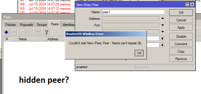

2, weird behavior - see pics. If I create a peer, mikrotik is hiding it but it still exists, I tried to create peer1 - peer3, none was shown in ip/ipsec/peer, but mikrotik refused to create a peer with this name, complaining “Name can’t repeat”.

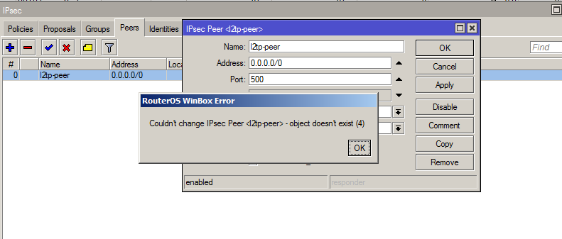

Similar to this - while having a peer l2tp-peer as you can see, mikrotik complains “l2tp-peer - object doesn’t exist” or “peer does not exist” - see attached images from winbox.

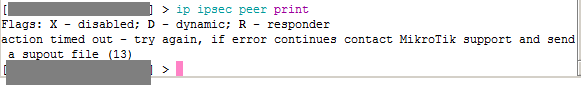

3, this is super weird - I can’t even print peers using ip/ipsec/peer print, it freezes for ~10 mins and then throws this error
