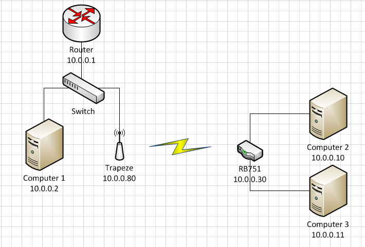

Attached is a basic layout of our network. What would be the recommended WLAN mode for the RB751 in this case?

When I manually add an IP and MAC address to the Computer 1’s ARP table it’s able to communicate with Computer 2 and Computer 3.
Could this be caused by the ARP setting for wlan1?
The mode you are using is only intended to bridge one device
See
http://wiki.mikrotik.com/wiki/Manual:Wireless_Station_Modes
Nick.
Hi, Nick, and thanks for the reply.
I did read the Wiki, and as far as I could tell from this sentence, station pseudobridge and station pseudobridge clone is to be used if the RouterBoard is bridged up against a non-RouterOS AP, or if only one end-user device is connected. As the RB is connecting to a non-RouterOS AP I assumed that this would work just fine.
The usage of this node can only be justified if AP does not support better mode for L2 bridging (e.g. when non-RouterOS AP is used) or if only one end-user device must be connected to network by means of station device.
Which mode is recommended, then?
Instead of bridging you could route.
You would use station mode on the RB751 and then either NAT the clients behind it, or route an extra subnet for them.
Nick.
If we were to remove one of the computers from the MikroTik, would pseudobridge clone work as it’s supposed to?
