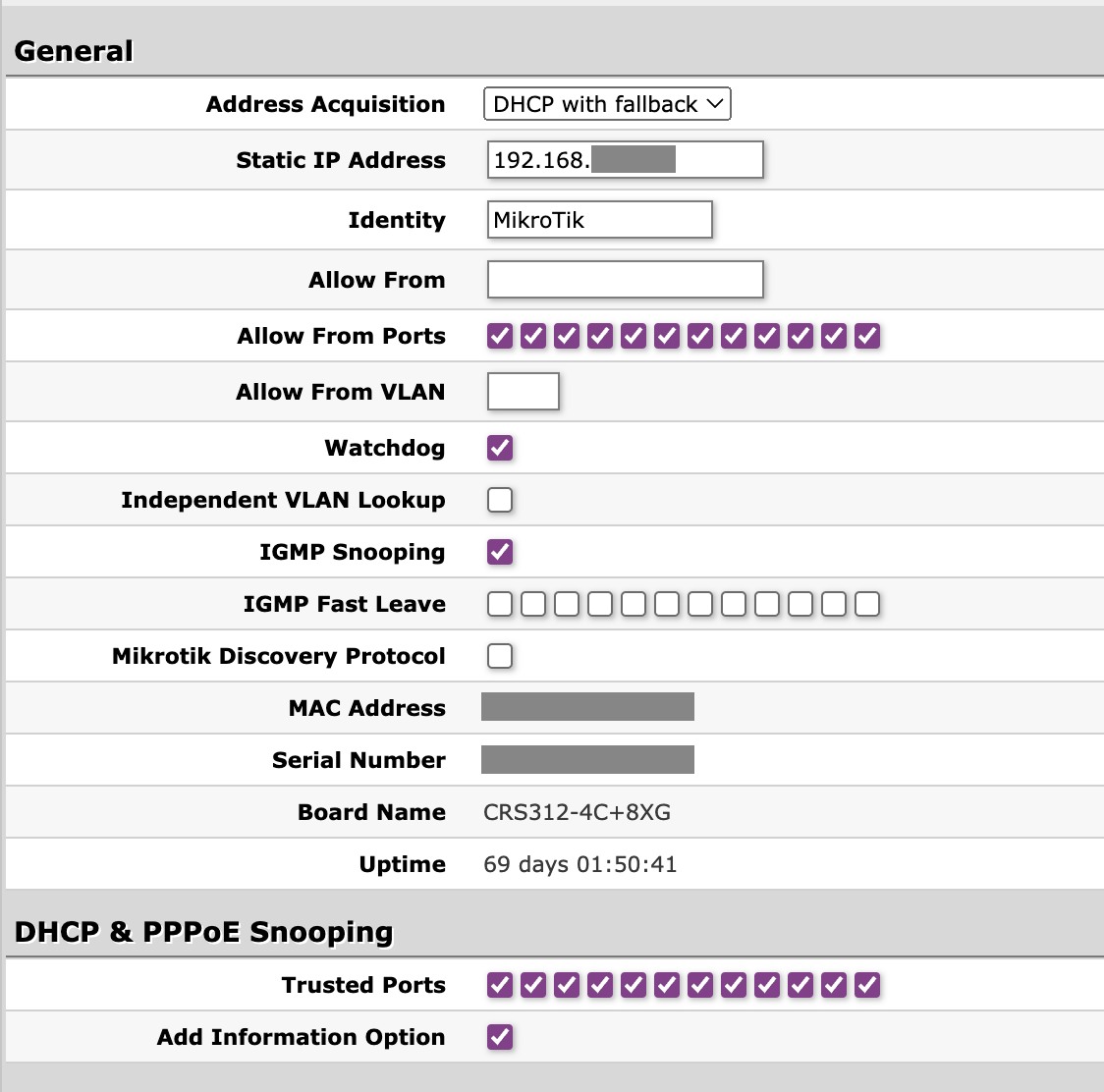

If your setup includes multiple SwOS devices, try disabling the System “Add Information Option” setting on all switches and let us know the results.
If your network includes other devices that might add Option 82, ensure the SwOS ports connected to those devices are marked as “Trusted,” as described on the SwOS System page.
Ports that receive DHCP client packets with already added Option-82 must also be trusted, otherwise these packets are dropped.

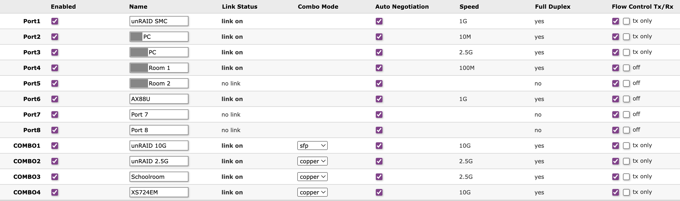

I’ve attached screenshots of the GUI’s Link and System tabs on 2.13. The Link tab shows all the currently connected devices and the negotiated speeds. The DHCP port will be COMBO4, which is connected via 10GbE copper to a Netgear XS724EM switch (firmware latest at 1.0.2.8 ). The XS724EM switch is connected via SFP to an Asus AX89X router.
Not sure if this matters, but there is a Wi-Fi node connected to the CRS312 (labeled AX88U). I first became aware of the problem in 2.16 because all my wireless clients were dropping off that node. That’s when I saw that every device connected to the CRS312 was no longer reachable.

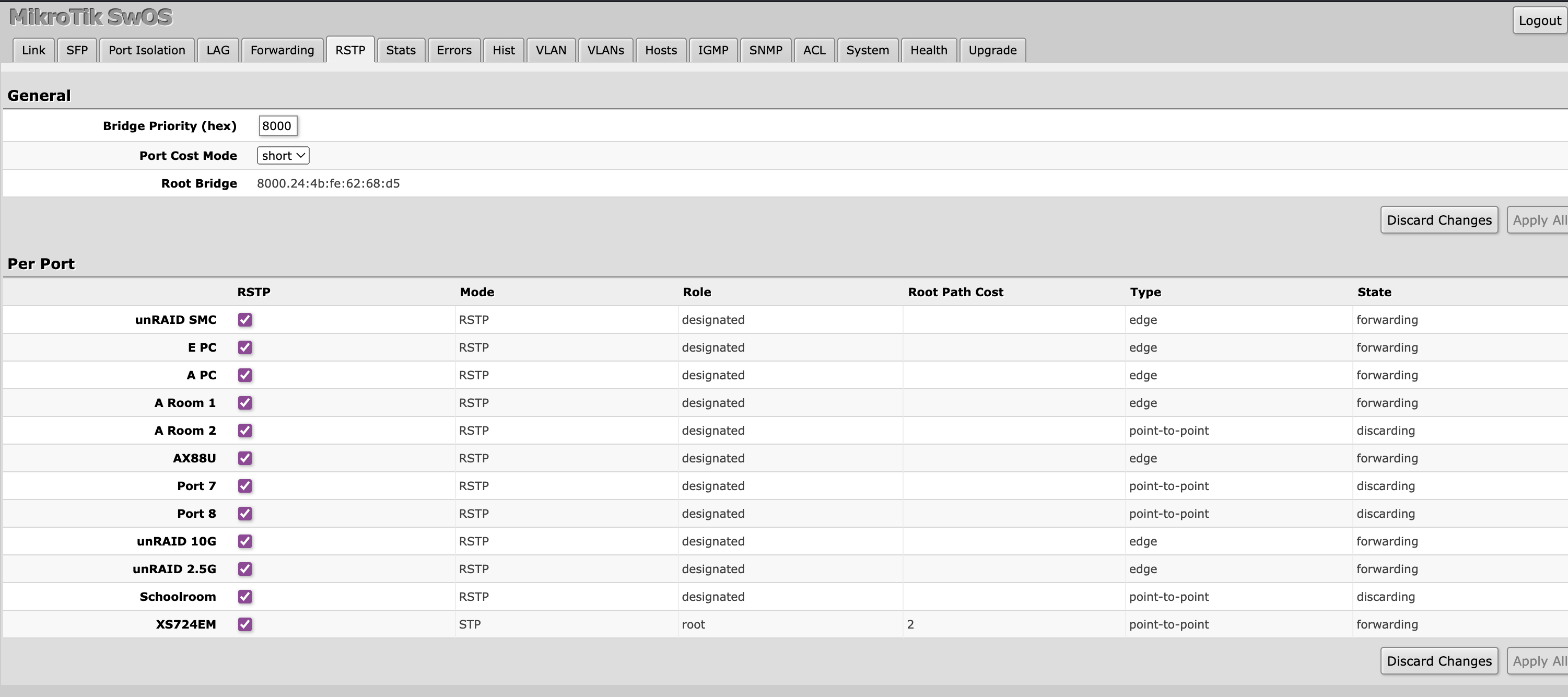

While you are at v2.16, check if any of the ports on the SwOS RSTP page show State “discarding”, while they should be “forwarding” (ports that are up and running and not creating a L2 loop). Also, try disabling “Add Information Option” on the System page, and see if that makes any difference.
lukasj, please make a report as well.
Okay, I upgraded to 2.16 via the GUI this morning. I have a busy day and don’t have time to dig into the steps required for DHCP packet capture. I am seeing “discarding” on a number of ports on the RSTP page, but each of these links is currently inactive/unused.
“Add information option” is unchecked on the ‘System’ page.

Well, we’re now at two full days of uptime, which is more than I had previously on 2.16. It looks un-checking the “Add information option” was important to the stability I’m now seeing.
