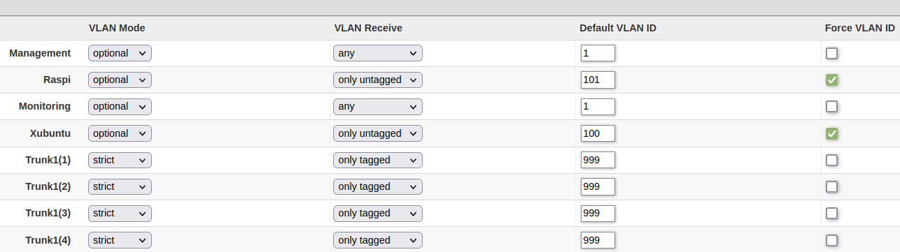

  • The packets get tagged correctly with VID 101 while it enters the access port [2], e.g sent by “Raspi”
  • afterwards it gets passed to the trunk port that is monitored and furhter to the other switch
    Let’s assume for a second the access port would NOT tag the packet but the trunk (after it splits the monitoring part): How could the trunk port “know” what VLAN to assign?
    IF (and that’s a very hypothetical “IF”) the trunk would tag it, I would expect it uses his default VLAN 999.
    But I see the packets are correctly tagged with 101 on INGRESS of switch1 (TPLink).
