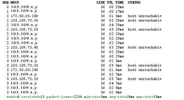

Over sudden can’t access internet from LAN. While looking for the possible issues, noticed that when pinging gateway (ping 103.109.x.y), strange IPs appeared in output (see screenshot). Plus, packet-loss is -225%.
What does that mean? How comes that it tries to ping other IPs?? How comes that while sent out 4 packets, it received 13?? Never saw this weird ping output before…

When I connect WAN cable directly to computer, it works fine and ping command works as usual. ISP said there is no problem from their side.
I plugged WAN cable to another RB port and configured it accordingly. It works. I connected it back to the original port and it shows the same as I described above.
