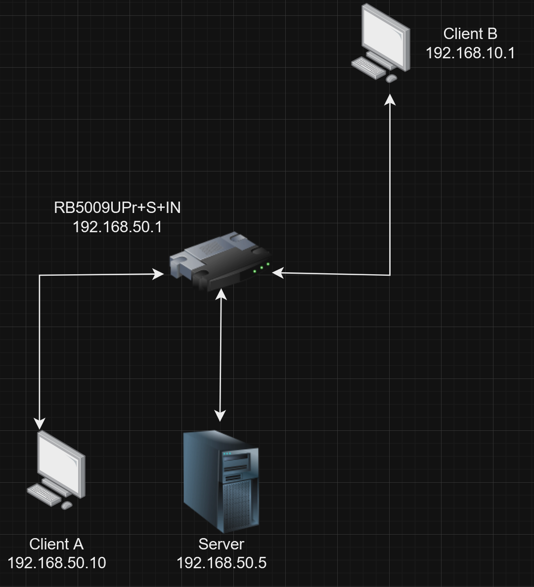

I have a RB5009UPr+S+IN running routerOS 7.11.2.
It runs a DHCP server for the CIDR 192.168.50.0/27.
I have a computer (Client A) and a server which receive their IP from the DHCP server.
Connected to the RB5009UPr I also have a computer ( Client B) with IP address 192.168.10.1 ( which is static and not managed by the RB5009UPr )
On the server, I’m running a simple web service which listen on 192.168.50.5:443
When I try to access it from Client A ( 192.168.50.10 ) all is working fine.
But when I try to access it from Client B ( 192.168.10.1 ), I have initial delay of 60 seconds to be able to access the server, then about 2 minutes of normal behavior and 20 seconds where the server is not reachable( an it restart with 2 minutes/20 seconds cycle )

Does the Client 2 computer know that 192.168.10.2 is it’s gateway?
Yes, Client B ( or your client 2 ) does know this route ( I’m not sure it would even work at all without it ).
