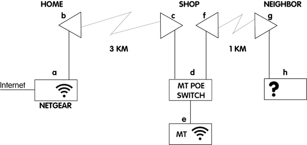

Customer’s workplace has no Internet provider, so he has installed a small custom all-Mikrotik network to feed Internet from his home, approx. 3km away using a pair of SXT5sq in transparent link mode (b/c), a POE switch in the shop (d), and a small MT router (in bridge mode) to supply WiFi signal (e). The entire network was bridged to his home router (a), which is a Netgear, the only non-MT unit. He ran bridged so he could access all his devices from either location, just like one might to a shed or other outbuilding. All networking units were hardcoded with static IP addresses in 192.168.1.0/24 outside the DHCP range configured in the Netgear. Non-networking units in the shop fetch IP addresses from the home Netgear.
Some time after establishing this link, an envious neighbor in the work complex asked him to share a taste of his Internet; so he set up a second link (f/g) between their two shops, about 1km, still bridged, same addressing rules. Inside the neighbor’s shop is a SOHO router, double-NATting, but no one cares. So now the network looks like this:
Traffic works fine, but there is a weird speed issue.
The network will push about 30-45Mbps (which is plenty, as it exceeds his home gateway speed) in each direction over almost any combination of links. The exception is end-to-end: unit b to unit g, which runs spastically around 10Mbps. If speed is measured from c to g, or b to f, full speed is seen. The only time the speed drops is when both wireless links are in play.
I’ve assured myself that both links are on different channels, so it’s not an interference issue. I have turned off STP/RSTP on every device in the network (save possibly the MT POE switch, which has a global RSTP setting that I can’t puzzle out, and refuses to upgrade from 2.4). I’ve assured there are no duplicate IP addresses anywhere in the network. It’s not the CPU load of bandwidth test, as I can get fine speed results between any two SXTs other than the two farthest apart. I’ve disabled g’s Ethernet link and run the speed test, just to ensure that nothing going on inside the neighbor’s shop is doing something strange, and results are the same. There are only about a half dozen devices in the main shop, so it’s not a bridging overload. The wireless distances involved here are quite modest.
Why should the speed drop precipitously only in the end-to-end case? I feel like i’m missing something basic, but I can’t find it.

I can think two tings:
  1. better see the exports of all 5 devices
  2. when tested with only one wifi at time, no problem,
    when tested involving both wifi at same time, both radio disrupt others radio signal for ROS and interferencies.
    Probably physically too close and frequencies not with one hole of at least 60MHz between or overlapped like 5500 Ceee / 5600 eeeC etc.

Bridges are in transparent mode (bridge/station-bridge).
b-c using 5230/20/an, f-g using 5220/20/an.
I thought I was guaranteed no mutual interference between single 5GHz channels.
I found a hole at 5200 and threw f-g down there, and the problem went away.
I learned something new today. Thanks for your help!
Well done, thanks.
But really all the credit goes to you,
without your precise description of the problem, I would never have had that intuition.
ROS lets one set things which are not exactly according to standards / best practice. If you check the list of 5GHz channels you’ll see that valid channel frequencies for 20MHz channels are 5220MHz (channel 44) and 5240MHz (channel 48) while frequency 5230MHz (channel 46) is valid for 40MHz channel. However, with Mikrotik notation of channels - 40 MHz channels are actually 20+20MHz channels with channel setup Ce or eC - one should still use the 20MHz channel frequencies when setting channels for any channel width.
BTW, your UDP tests (being almost as bad as TCP) proved that my theory about delays was wrong. For that part the test still proved useful even though most traffic over link is TCP.
Holy ****! That went right over my head! The customer did that, and I never even noticed. (My recommendation of 5320 got transposed at one point to 5230 and that was the number he ran with. I would have noticed the lack of bold type; he didn’t know what it meant.) So the frequencies were actually overlapping after all! I was under the impression that RouterOS would simply refuse to use a half-channel frequency, so I never even checked for it.
I just reached out and reset his home link to 5240, which works just as well for him if not better, and doesn’t cross channels.
Thanks for catching this.
