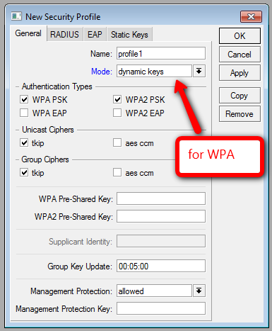

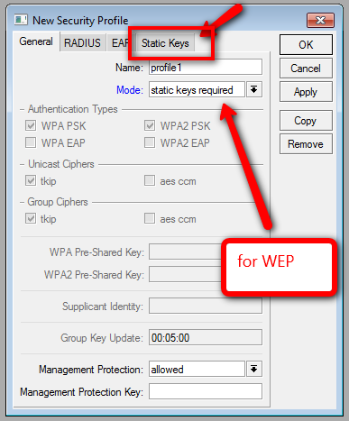

WEP is configured elsewhere, just like the manual explains:
http://wiki.mikrotik.com/wiki/Wireless#WEP_properties
So … look at the pictures:

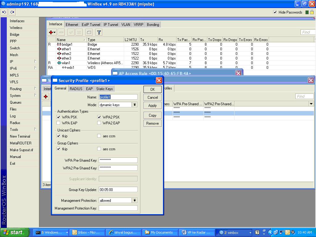

The configuration on CPE and the AP is same, likes in the picture below.
If pre-shared key is different between CPE and the AP, CPE and the AP are still connected.
Where is the mistake configuration?
rgds,
F0B
is wlan card assigned profile1, or default?
wenas
June 2, 2010, 2:24am
11
wlan is assigned by profile1.
My problem is : even the AP is assigned by profile1 and CPE is assigned by default, they are still connected… they should not be connected, right?
Profile1 on the AP in this case is not working.
any idea?

[admin@RB] > /interface wireless export
jan/01/2002 01:00:25 by RouterOS 4.9
software id = 05RX-71I2
set default authentication-types="" eap-methods=passthrough group-ciphers=""
group-key-update=5m interim-update=0s management-protection=disabled
management-protection-key="" mode=none name=default
radius-eap-accounting=no radius-mac-accounting=no
radius-mac-authentication=no radius-mac-caching=disabled
radius-mac-format=XX:XX:XX:XX:XX:XX radius-mac-mode=as-username
static-algo-0=none static-algo-1=none static-algo-2=none static-algo-3=
none static-key-0="" static-key-1="" static-key-2="" static-key-3=""
static-sta-private-algo=none static-sta-private-key=""
static-transmit-key=key-0 supplicant-identity=MikroTik tls-certificate=
none tls-mode=no-certificates unicast-ciphers="" wpa-pre-shared-key=""
wpa2-pre-shared-key=""
add authentication-types=wpa-psk,wpa2-psk group-ciphers=tkip
group-key-update=5m interim-update=0s management-protection=allowed
management-protection-key="" mode=dynamic-keys name=profile1
static-transmit-key=key-0 supplicant-identity="" tls-certificate=none
tls-mode=no-certificates unicast-ciphers=tkip wpa-pre-shared-key=
Welcome10 wpa2-pre-shared-key=Welcome10
management-protection-key="" mode=dynamic-keys name=profile2
radius-eap-accounting=no radius-mac-accounting=yes
radius-mac-authentication=yes radius-mac-caching=disabled
/interface wireless
set 0 ack-timeout=dynamic adaptive-noise-immunity=none allow-sharedkey=no
antenna-gain=0 antenna-mode=ant-a area="" arp=enabled band=2ghz-10mhz
basic-rates-a/g=6Mbps basic-rates-b=1Mbps burst-time=disabled comment=""
compression=no country=no_country_set default-ap-tx-limit=0
default-authentication=no default-client-tx-limit=0 default-forwarding=no
dfs-mode=none disable-running-check=no disabled=no disconnect-timeout=3s
frame-lifetime=0 frequency=2462 frequency-mode=superchannel
frequency-offset=0 hide-ssid=yes hw-fragmentation-threshold=disabled
hw-protection-mode=none hw-protection-threshold=0 hw-retries=4 l2mtu=2290
mac-address=00:15:6D:65:F7:DE max-station-count=2007 mode=bridge mtu=1500
name=wlan1 noise-floor-threshold=default on-fail-retry-time=100ms
periodic-calibration=default periodic-calibration-interval=60
preamble-mode=both proprietary-extensions=post-2.9.25 radio-name=
"Office" rate-set=default scan-list=2300-2500 security-profile=
profile2 ssid=backbone1 station-bridge-clone-mac=00:00:00:00:00:00
supported-rates-a/g=6Mbps,9Mbps,12Mbps,18Mbps,24Mbps,36Mbps,48Mbps,54Mbps
supported-rates-b=1Mbps,2Mbps,5.5Mbps,11Mbps tx-power=17 tx-power-mode=
all-rates-fixed update-stats-interval=disabled wds-cost-range=50-150
wds-default-bridge=bridge1 wds-default-cost=100 wds-ignore-ssid=no
wds-mode=static wmm-support=disabled
/interface wireless manual-tx-power-table
set wlan1 comment="" manual-tx-powers="1Mbps:17,2Mbps:17,5.5Mbps:17,11Mbps:17,
6Mbps:17,9Mbps:17,12Mbps:17,18Mbps:17,24Mbps:17,36Mbps:17,48Mbps:17,54Mbps
:17,HT20-0:0,HT20-1:0,HT20-2:0,HT20-3:0,HT20-4:0,HT20-5:0,HT20-6:0,HT20-7:
0,HT40-0:0,HT40-1:0,HT40-2:0,HT40-3:0,HT40-4:0,HT40-5:0,HT40-6:0,HT40-7:0"
/interface wireless nstreme
set wlan1 comment="" disable-csma=no enable-nstreme=no enable-polling=yes
framer-limit=3200 framer-policy=none
/interface wireless wds
add arp=enabled comment="" disabled=no master-interface=wlan1 mtu=1500 name=
wds1 wds-address=00:15:6D:65:F8:4A
/interface wireless access-list
add ap-tx-limit=0 authentication=yes client-tx-limit=0 comment="Office2"
disabled=no forwarding=yes interface=wlan1 mac-address=00:15:6D:65:F8:4A
management-protection-key="" private-algo=none private-key=""
private-pre-shared-key=Welcome10 signal-range=-120.120
/interface wireless align
set active-mode=yes audio-max=-20 audio-min=-100 audio-monitor=
00:00:00:00:00:00 filter-mac=00:00:00:00:00:00 frame-size=300
frames-per-second=25 receive-all=no ssid-all=no
/interface wireless connect-list
add area-prefix="" comment="" connect=yes disabled=no interface=wlan1
mac-address=00:15:6D:65:F8:4A security-profile=default signal-range=
-120.120 ssid=""
/interface wireless sniffer
set channel-time=200ms file-limit=10 file-name="" memory-limit=10
multiple-channels=no only-headers=no receive-errors=no streaming-enabled=
no streaming-max-rate=0 streaming-server=0.0.0.0
/interface wireless snooper
set channel-time=200ms multiple-channels=yes receive-errors=no
[admin@RB] >
disable that access list entry and see what happens.
wenas
June 2, 2010, 11:01pm
15
Changeip, I will try ur advise n come here again soon
