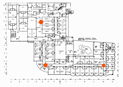

I want help, please… if I want to use Access Point in 4 floors building, and each floor have about 40-50 rooms, (it is a hotel building). can you suggest me what AP should I use to ensure the signal distributed to each room in each floor? and how many AP should I install each floor?
Note: it is difficult using Outdoor AP, because each side of the outer building verge with neighbor yard.
the picture above is the example sketch of that building
Thank you all…

The question should not be: “What Access Point is powerfull enough through many rooms”
The question should be: “How many 12mw clients can make it through many rooms to my APs
Building a strong AP with lots of xmit power to blast through an entire building is easy if you dont care about the quality of the client connections back to the AP.
You need to consider the client devices may be only 10mw hand-held PDAs which have a weak xmit level.
Plan your AP or APs so they have good antennas and good receive sensivity cards. You should plan your APs to be able to hear your weakest clients with SNR around 50.
