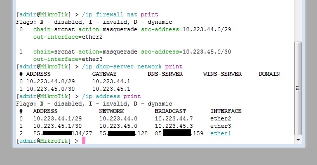

Please post “/ip firewall nat print” and “/ip dhcp-server network print”.
Can you ping ether2’s ip (gateway on that network) from a computer connected to ether2? If not, please post “/ip address print”. You may x out the first three numbers in any public ip if you feel security is a challenge.
ADD: Just to be sure…in “/ip address”, insure the correct ip/netmask is assigned to ether1.
yes i can ping the gateway from a pc connected to that network, but i’ve typed the command anyway.
I see the challenge. It is the nat. Remove both nats and instead use
add chain=srcnat action=masquerade out-interface=ether1
ADD: And if you want the dhcp clients to use domain names, I would insure you set the dns servers in
“/ip dhcp-server network”. Then have all dhcp clients renew their lease.

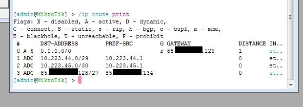

LE: What about the Routes?

Since you volunteered earlier, can you show “/ip route print”? Or screenshot if Winbox.
Just one second.
Here it is:
